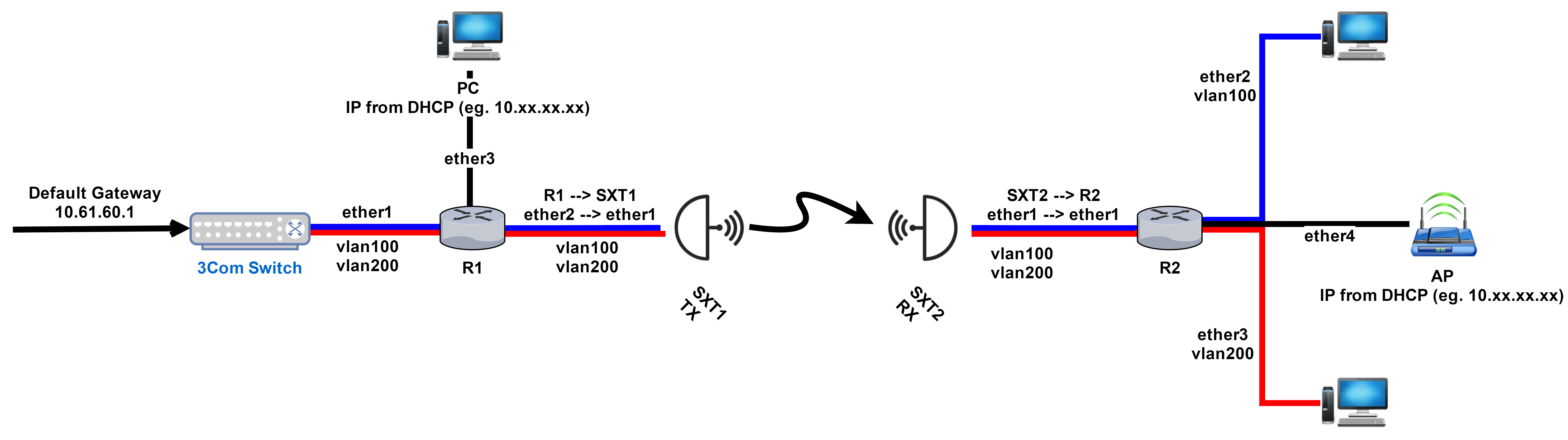

I need some help setting up the attached diagram :
[attachment=0]Setup.png[/attachment]
R1 :
ether1: Connected to 3Com switch with multiple VLANs
ether2: To SXT1
ether3: To PC with IP address (10.xx.xx.xx) matching the network (10.61.60.1)
ether4: (none)
ether5: (none)
SXT1 (TX) - (Station Bridge) :
ether1: Connected to R1 (ether2)
wlan1: Station Bridge for SXT2
SXT2 (RX) - (Bridge) :
wlan1: Bridge from SXT1
ether1: Connected to R2 (ether1)
R2 :
ether1: From SXT2
ether2: vlan100 (Automatic IP)
ether3: vlan200 (Static IP)
ether4: To Access Point with IP address (10.xx.xx.xx) matching the network (10.61.60.1)
ether5: (none)
Note:
vlan100 : VLAN ID=100
vlan200 : VLAN ID=200
How to configure R1, SXT1, SXT2 & R2 ?
Thank you

I would like to keep R2 for future network upgrade. I want to know the true config for each device. I manage to get the VLANs working at after R1, but I couldn’t figure out how to configure the rest. specially SXT1 & SXT2.
Any Ideas ?
