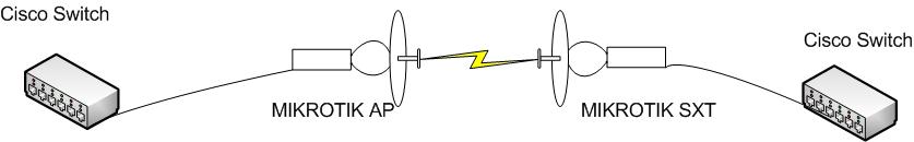

I am connecting two building for a client and he just told me there will be 6 VLANs needed for the remote building. I don’t have a lot of experience with VLANs and I’m not sure about the config. Here is the setup:
Any advice or can someone point me in the right direction?
IF i have understand clearly the diagram, it is simple just config the wireless link in mode bridge and it will pass all vlans as trunk do, and in the “station” cisco sw you will access vlans per port
This is the correct assumption.
