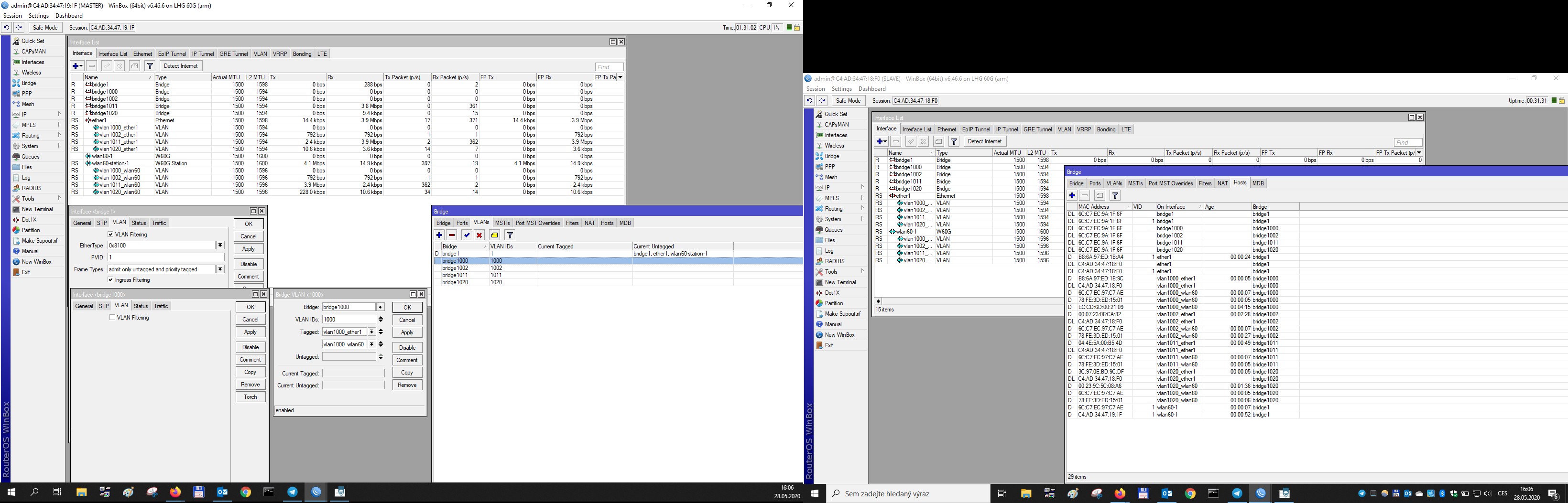

Below is my current setup which works , but i was thinking about having just one Bridge and use VLAN Filtering function to make it more simple if it’s possible, anyone?

Thx Anav for reply. I did another change to my previous setup and completly removed VLAN filtering function since i have been using separate bridges for VLANS.
But i took your advice and tried in like u typed and its working as well with just one bridge and VLANs seems function properly, im gonna do bit more testing in real conditions but again thank you for pointing me out.
