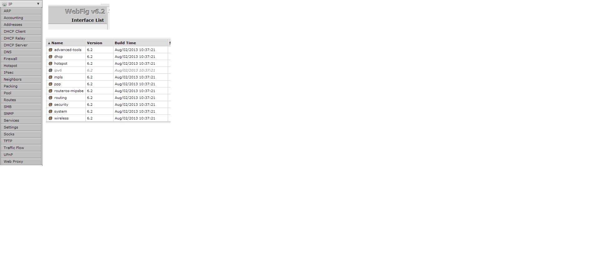

I don´t have /ip proxy but /ip webproxy
in line 7 what´s dst-address=192.168.80.80 , I have there my public address 213.125.xxx.xxx

I have no explanation how I can have “/ip proxy” and you “/ip webproxy”, when we both should have same RouterOS 6.2. We should sort this out first. In fact, the whole wiki example seems a little strange. I have currently access to RouterOS 2.9.51, 3.30, 5.24 and 6.2 and in all of them it’s named “/ip proxy” and none of them has transparent-proxy option you were missing. So where exactly is that example from, I have no idea.

Hi Thanks for your help, see attachment I really have V6.2 with web proxy
So what exactly you did? Did you enable proxy? Did you add firewall rule? Did you add dns entries? Do required hostnames correctly resolve to your public address? What happens when you try to open the web in browser? You can also run /export command and post the output here, that should answer a lot of these questions.
