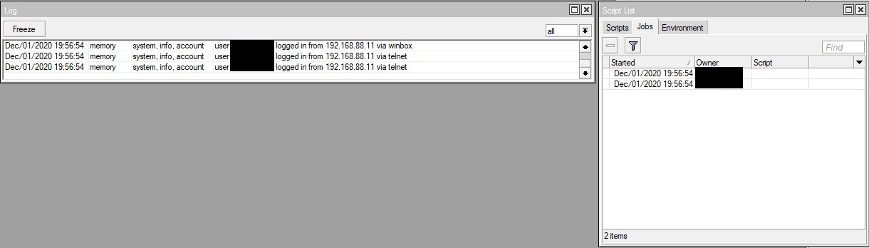

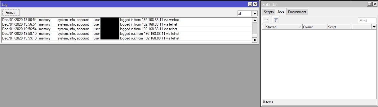

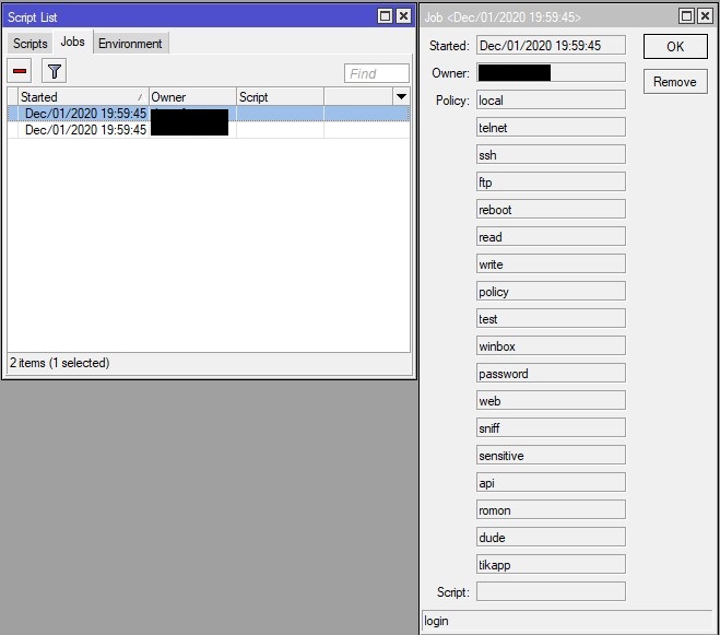

When I log in via winbox, there are multiple logins for the same user visible in logs and immediately the same number of jobs running is created where the owner is the account which was used to access the device (IMG1). What I find disturbing is that the telnet service is disabled and the additional logs seem to use telnet nonetheless. There are no existing scripts visible in the scripts section, neither is there a script name next to the job. When I delete the jobs, the additional logins are logged out at the same time according to logs (IMG2). The job detail is visible on IMG3. Is this usual behavior or is the device infected? I did a netinstall with format but the additional logins are persisting.

I wonder if we can get this post noticed by someone who knows. One thought is that I’m running CAPSMAN and wonder if a telnet session is used to pass info by to CAPS. Another thought that concerns me is if one, or more of my RouterOS have an old leftover security breach with scripts running in the background. I think I remember reading about a security issue where a hidden script was placed on the system.
When running the latest version of winbox (3.29) each telnet session shows up on the lower left panel as a window so it’s easier to notice the issue.

Do you hapen to have command line windows (Terminal) open in the winbox sessions in question?
I don’t use Capsman, but recall reading here on the forum that what you are seeing is normal for a Capsman installation.
Hi Sindy,
Actually, yes. …and I think you solved the issue. I noticed the issue before using WinBox 3.29, but now that I’m running 3.29 the Terminal appears to be associated with the additional admin user login and script job. I thought I had closed the Terminal Windows, exited, then re-launched WinBox to find that the user was logged in and script job running again. After your post I saved the session after closing Terminal Windows, exited, and now the additional log-ins, script Jobs and Terminal Windows to not appear. Seems simple now, but was driving me nuts. Thanks for your help.
