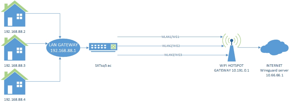

Hello, I need help on how I can create for multiple wlan interfaces a connection using wireguard for each of the wlans. I show a basic diagram of the problem. Thanks in advance.
The requirement is not based on users so quite frankly I dont understand why you need a wireguard tunnel for each WLAN.
I only see one subnet of users and they are all on the same subnet.
Do you mean each WLAN is like a different ISP, WAN1, WAN2, WAN3 ???
The wireguard server what is that, another mikrotik at another location or a 3rd party vpn provider. (If its the latter they need to provide you with 3 wireguard IP addressess for example.)
Thanks for replying, indeed each user on the subnet must have their wan out through their wireguard client. the wireguard server is a third party server installed on a ubuntu server. that is, I put a wireguard tunnel on each wlan.
Third party is NOT unbuntu server, third party is a company that provides Wireguard through an internet server at some location.
I am assuming you have access to the ubuntu server etc, so that you have some way on the ubuntu setup.
Your answer is still not clear,
Are all users, that appear to be on the same subnet go over the same WAN to the wifi hotspot?
You really need to post the SXT config

My original configuration is with 10 wlan, each person must have access to their wifi portal, and when that person has authenticated, the wireguard tunnel would connect automatically. I tried to make a configuration but it did not connect me, my IP is 110.220.40.3 in the configuration.

So to be clear,
the requirement is a one to one relationship…
user1 to WAN1 (WLAN1)
user2 to WAN2 (WLAN2)
user10 to WAN10 (WLAN10)
Also clarify that each user is accessing internet via the wirguard tunnels, if so quite correct,
you need 10 wireguard interfaces on the client as well to avoid overlapping peers.
Yes effectively. what with an example of 3 wlan is enough for me to continue working. wireguard tunnels are not a problem, I can generate as many as I want. The problem is that with this Wi-Fi multiportal connection, the tunnels do not connect to me. any suggestion?
thanks
pd: if there was any configuration that responded to this situation, other than mine, it would still work for me and I change all my configuration.
Very confusing, is this the scenario then…
There is one hotspot wifi that the STX. Since only one authentication can be done from one WLAN, you require multiple WLANs for all to log into the hotspot. … if that makes sense… So the user has to authenticate to the hotspot and then the user has internet connectivity and then you want them them to go through a wireguard tunnel for internet. Close??
I am not sure that is even possible?? Never mind the wireguard I mean the initial connecting…
forgetting the wireguard connection. My configuration connects through the SXT to all users, giving each one a different portal to the wifi, this works perfectly.
I want to add the tunnel to each of those connections. And that automatically that the user is authenticated to the wifi, logically the tunnel must see the wireguard server and connect, I think…
user1 → wlan1
user2 → wlan2
etc
I can’t play with it now, but it shouldn’t be too hard. Basically you need “two layers of multi WAN”. First for wlans, you have that. Then you need to make WG tunnels each use own wlan. For that you set different listen port for each WG interface and then mark routing based on this source port. Then comes second layer, where WG interfaces are actual WAN interfaces used by clients. So you need another routing table for each, and from there it’s standard multi WAN.
That is what I am having difficulty understanding.
Do you create a separate virtual WLAN for each client ??
How is each v WLAN then connected to the wireless portal…???
In any case not possible without mangling… sorry.
Exactly, each user has their vwlan with a portal, each vwlan is connected as a client to the AP. What I want is that when the user authenticates, the wireguard tunnel connects.
Sob is on the right track…lucky guess I am assuming. :slight_smile:
yes, I think Sob is right, I hope to have some more concrete clue from him at some point :slight_smile:. but thank you very much Anav for the help too
Experiment a little bit, I can’t do everything. :slight_smile:
