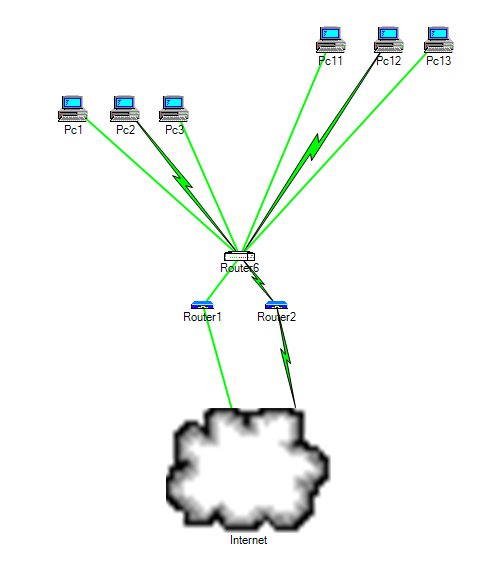

Probably as BartoszP is worried, I’m not smart enough to make simple queries, however I’ll try again with a graphic, maybe I can express myself in a better way using an image. :sunglasses:
I would like to instruct the router to permanently route PC2 in LAN1 and PC12 in LAN2 to always use Router2 and all other boxes to always use Router1.
Since there is only Router6 connected to the PCs I cannot use the “route” command on the PC and the “route” command in the routers I’ve used only change path based on destination, not source.
Is this different in MT routers? Can I change the route based on the source instead of the destination?
