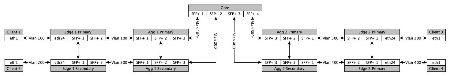

i´m currently managing a network of around 40 switches, using CRS326 for access, CRS309 for aggregation and one CRS354 as core. All switches except the core are used in primary/secondary pairs linked to each other for redundancy. All redundant ports are correctly disabled by RSTP. This week i´ve discovered MVRP which seems really useful for the setup. Unfortunately the MVRP packets still pass through the ports disabled by RSTP, creating a loop by declaring and registering every vlan present in the whole system, even the ones not used there.
In this example, im seeing MVRP adding all 4 VLAN to all switches.

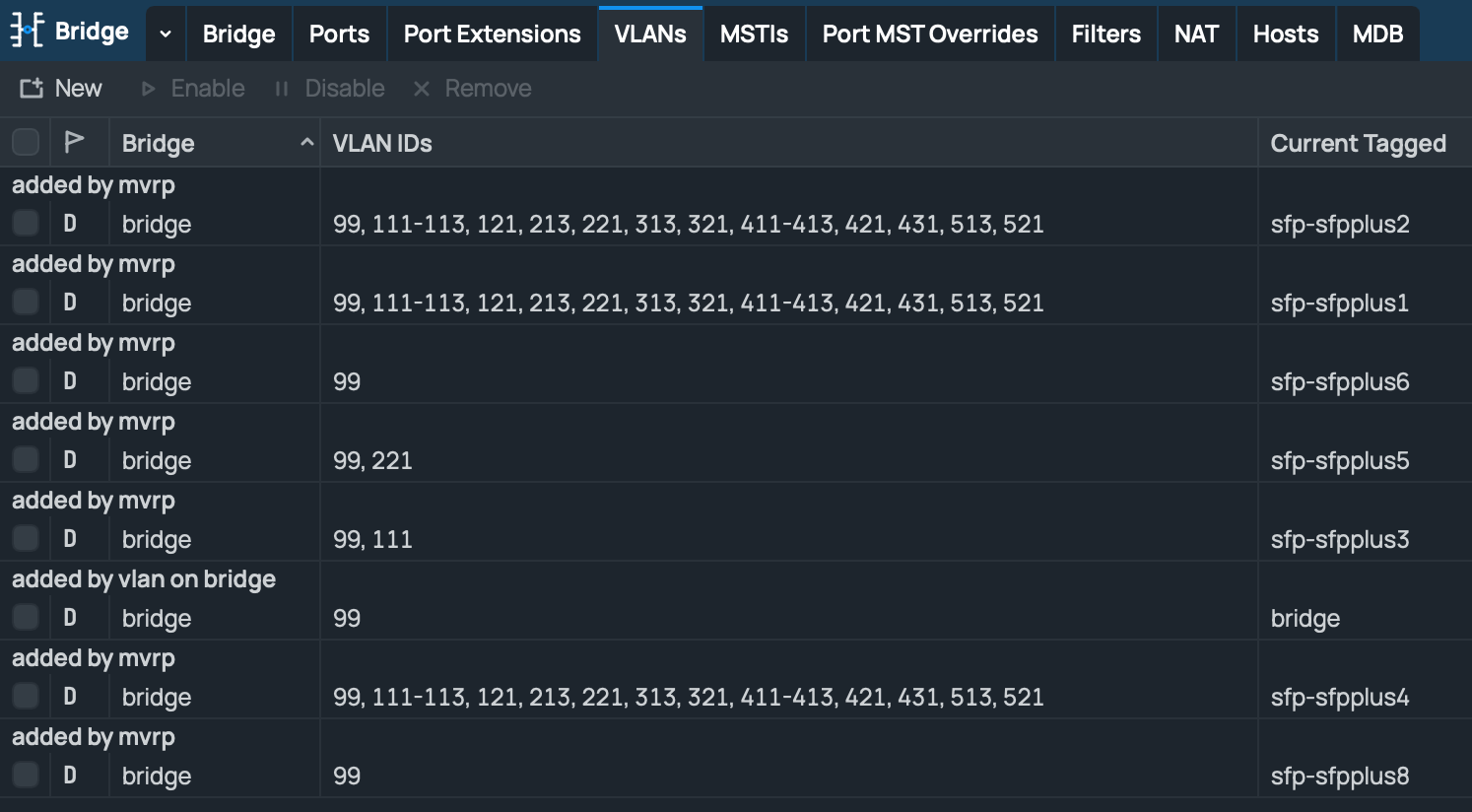

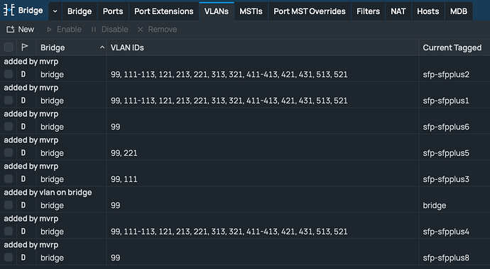

ive detected the behaviour while looking at the bridge/vlan view in winbox:

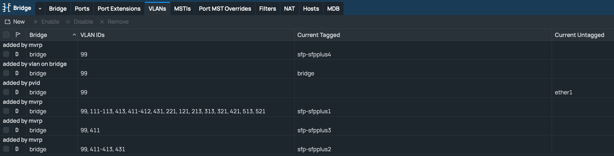

in contrast to
