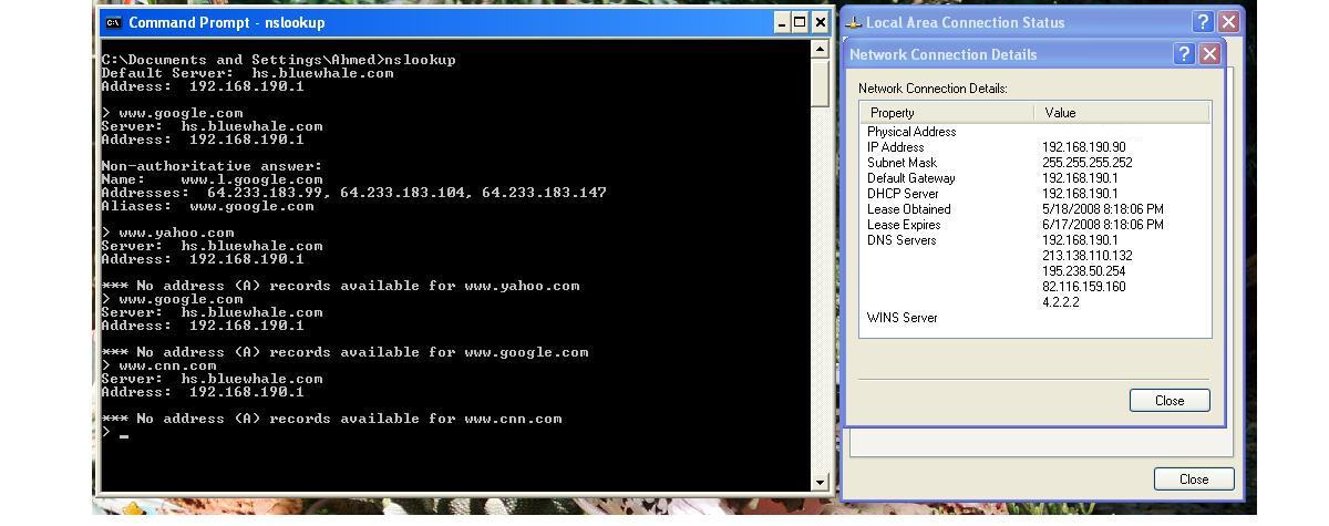

the photos below showing you my settings to the DNS server in the MT and DHCP output to users regarding the DNS servers .
also you will see what the nslookup command gives when the problem happens where the Yahoo messenger stop and browsing stop and pop3 stop .

Hi..
In your DHCP server settings, only give your MT Router’s IP address as your DNS server. You are giving other IP’s also as secondary DNS server.
Check your ISP dns servers for reliability.
I have had exactly the same problem as you.
At first, mudasir already mentioned it, it has no use to put extra dns server IP’s in the dhcp if these are the same as what you set already in the MT dns cache server.
The MT box sends the dns request always only to the first dns IP mentioned as the Primary DNS.
Only if this Primary DNS sends a message back it cannot resolve the MT will send the request to the Secundairy DNS.
But, if the Primary DNS is just not reachable (it is down) the MT box will keep on trying untill it recieves either the dns resolvement or the message it cannot be done.
If the MT box this way cannot resolve the dns request, it sends this message to the station requestioning. But by dhcp you gave this station as second and third option only the same dns IP’s the MT box already failed to use, so only option 4 the very last, is left for the requesting station, and by the time this DNS IP will then be able to supply the request already loads of microseconds have passed. So dns resolving becomes very slow (and thus browsing)
I worked with both given DNS1 and DNS2 IP of my ISP as Primary. But both DNS servers I found to be very unreliable. I even tried ´open dns´ as my Primary and even there I had problems.
Then I started using an DNS Ip from my countries major ISP (Former national Comm firm) which I happen to have on a standby modem and since then (3 months now) never had any problems no more!
I still use the first provider for all my traffic, since it has high bandwidth, while all my dns requests are now routed (and dst-nat’d) through the modem of the low bandwidth ISP. All clients are now very happy, never seen so fast browsing and like said, its working now for about 4,5 weeks without a single interrupt! :smiley:
