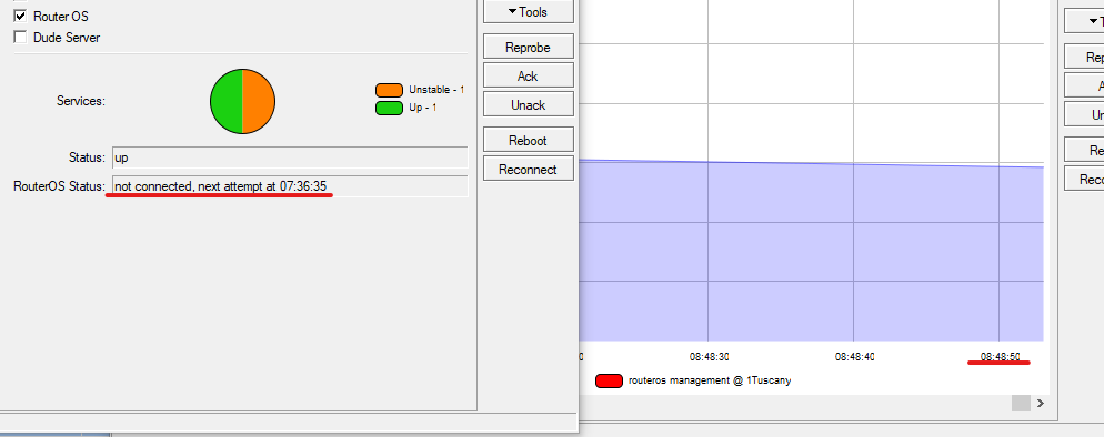

My issus is that the reconnect time on RouterOS connections seem to be stuck at GMT+0.
Attached is an example.
You can see my time on the History graph is 08:48:50.
Then you see on teh RouterOS STatus it says reconnect at 07:36(Remember to remove a 30 Min period as that is my Routeros Reconnect Time - 30 Minutes)

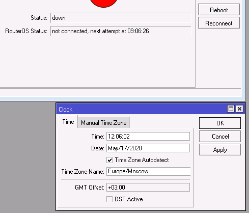

Same problem. The time zone is not taken into account, it shows GMT+0 time.
