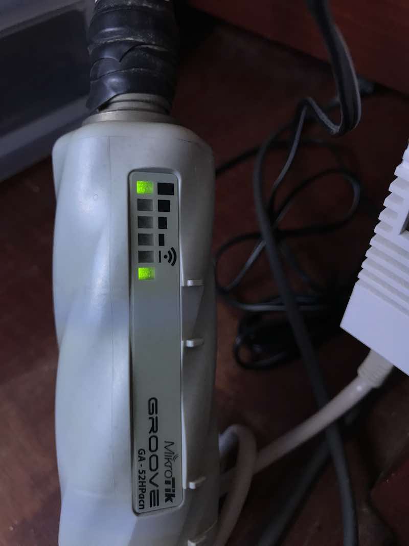

My Groove AC seems to have stopped responding to any network requests, and shows no connection on the network.
The on POE the top light and bottom light of the Groove AC come and and nothing else.

Here are the lights. These two flash on startup, then eventually remain permanently on.
It sounds like your groove is not completing the boot. The best I can suggest is to attempt to try reloading the OS by using netinstall.
Can’t do a Netinstall as the device doesn’t respond to anything, and isn’t found in Netinstall. It turns on, and then gets super hot that is about it. I’m guessing these things only have a 12 warranty.

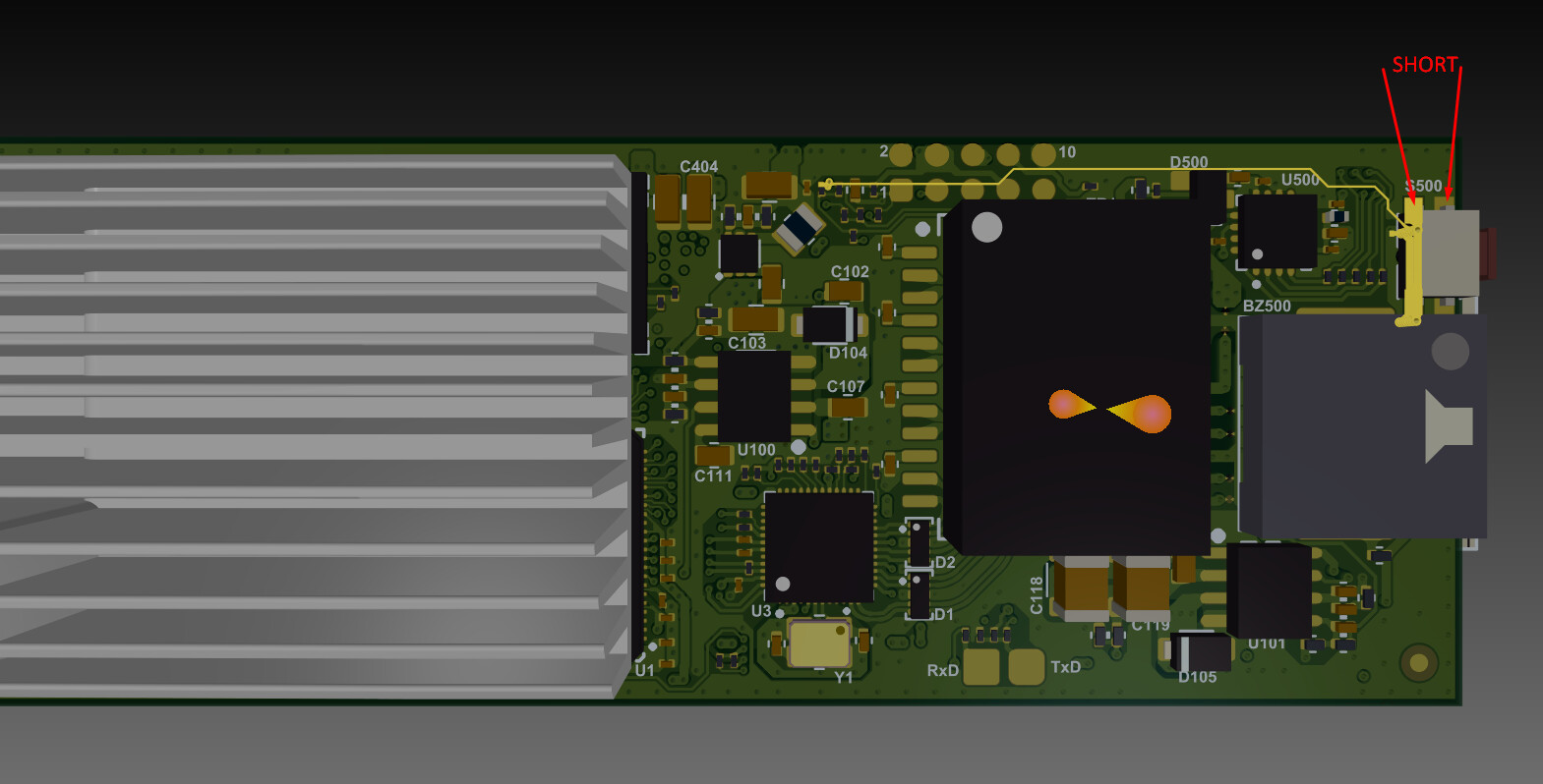

Where is the reset on the Groove 52 AC then? It’s not like on the original groove nor like the Hap AC. There are no images anywhere showing it especially not in the wiki.

Thanks, but no, the Groove AC is very different in terms of the board, hence my post above. I don’t think there is anything online about resetting the Groove AC manually. I think it needs a Mikrotik representative to tell people how, as it seems different from all the others I’ve seen.
I think the board is the same like nonAC Groove with different cpu and ethernet port !
It’s similar. But not the same. In the video you can see by the base of the board there are two holes with contacts around. The guy in the video uses a screw driver on the left contact to reset the board. On the AC board there are no holes, only one contact and sticking a screw driver on it achieves nothing at all. In the video you can clearly see the contact the guy uses to reset the board is split into two parts. He jumps those two part with the screwdriver. On the AC board, this doesn’t exist.

Mikrotik did get back to me in the end on manually resetting this, but it’s basically just the reset switch contacts. Very different from other routerboard type equipment.
