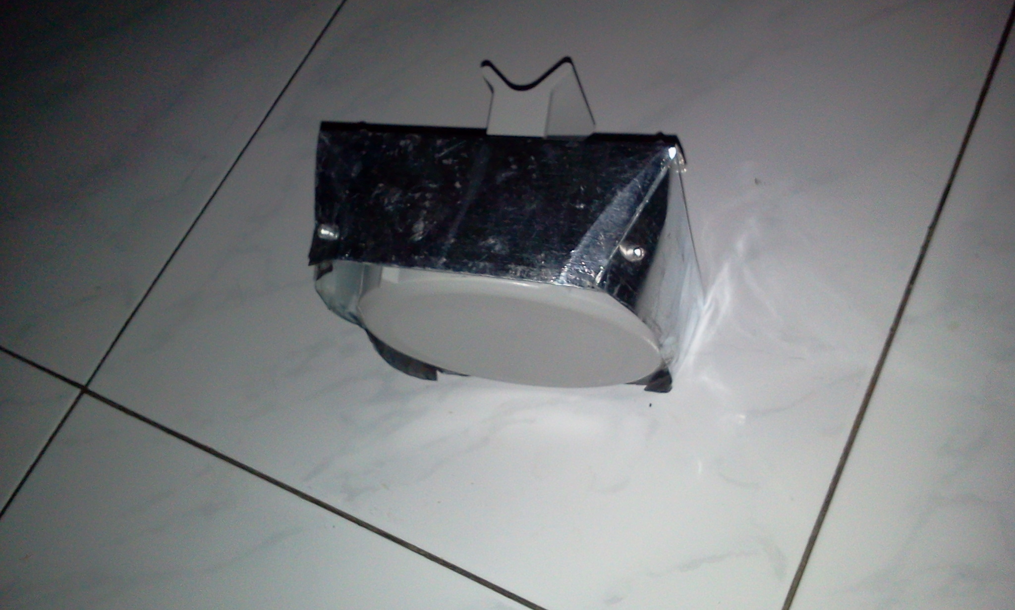

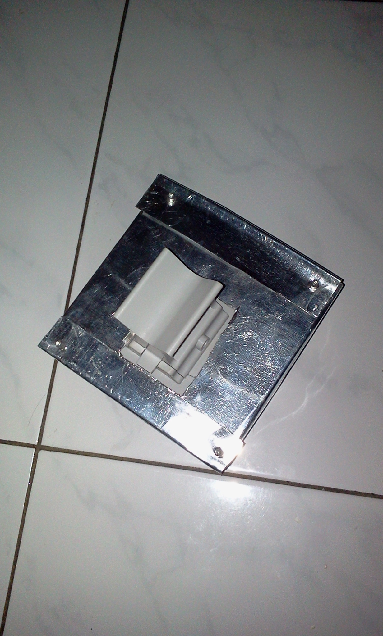

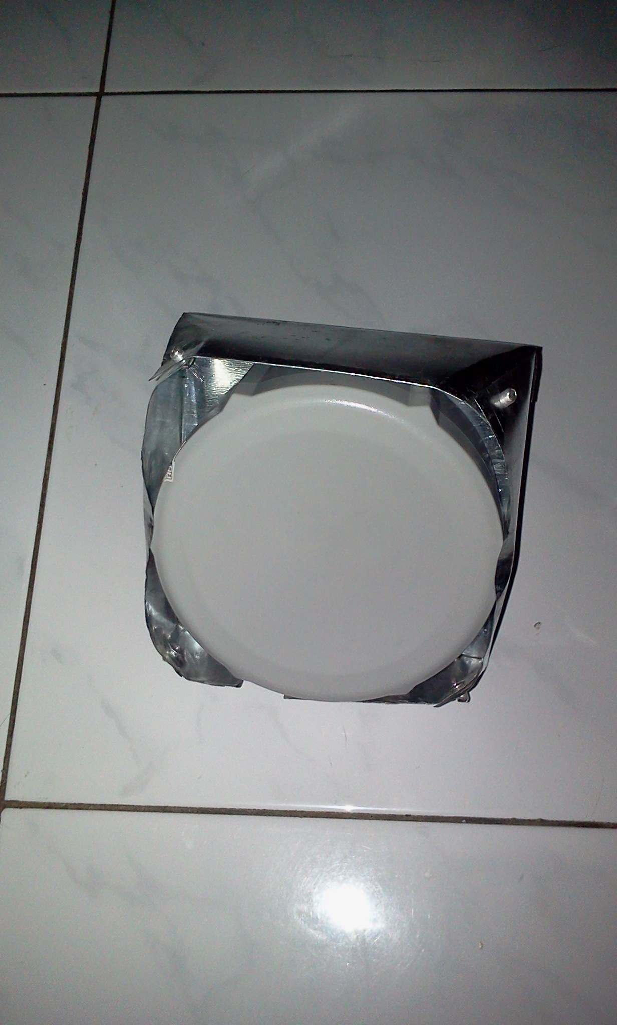

my homebrew SXT shield
am i gonna reduce noise with this?
It depends while you have shielded sides you have omitted part of the back of the SXT and being plastic will allow RF signals through, my home brew is here http://forum.mikrotik.com/t/nv2-disconnect-problem/55769/1

20mm copper foil painted over with conductive paint and earthed which after a quick test greatly reduced signal pickup from rear.

Another thing is that RF physics are not that easy and everything has to be carefully calculated and tested by people that know what they are doing. I for example bought today some high quality aluminum heat-shielding tape and laid all the backcover of one SXT & SEXTANT each and now I’m not sure if it does more good or bad (multipath reflections)..
I usually use in my test setup make note of signal reading before the start of modifications and then compare after for example on one live AP I noted all CPE’s signal + CCQ removed the AP from brackett (so it would be put back exactly in the same position) then after RF screening was done compare the CPe’s signal + ccq for any reduction in signal which would indicate a change in AP TX beamwidth as this did not happen I concluded that beamwidth remained the same, this works for me until some manufacturer builds a AP which they can certify works NV2 in noisy locations and is tolerant to co-location interference.
