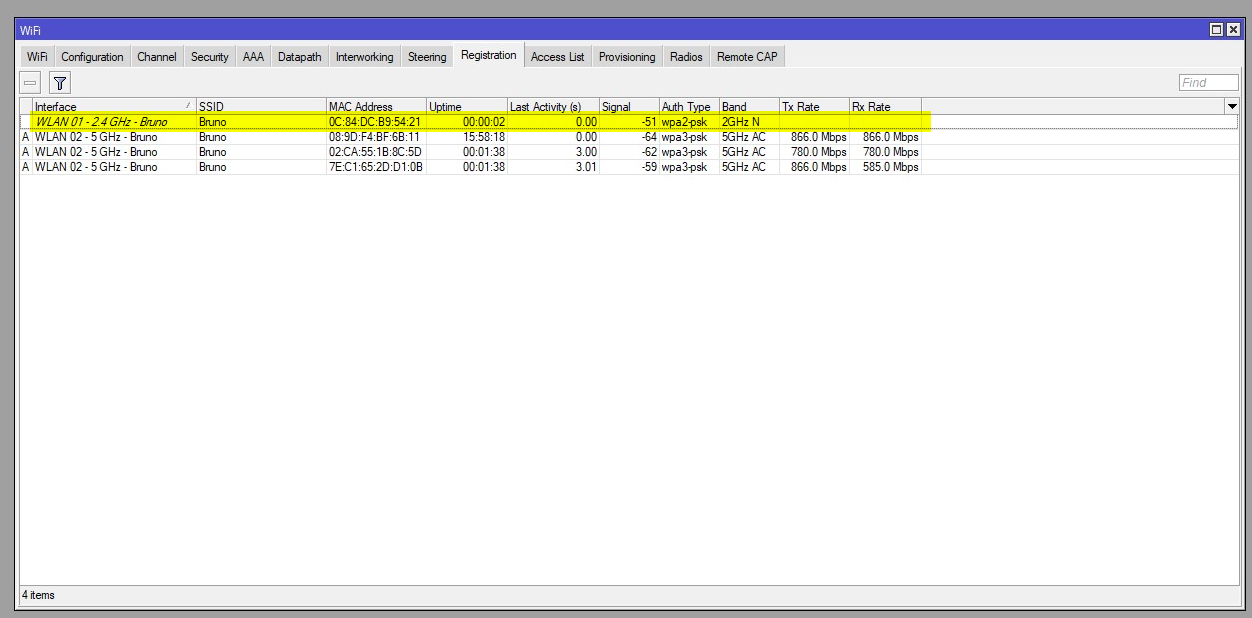

Just to home in on the problem a bit more, does anything else [mobile phone?] work on these SSIDs - and if they fail, how far do they get with connecting?

ALL other wireless devices (smartphones, PC/notebooks, PlayStation,…) connect and work w/o any problem (see also the screen shot from the Registrartion window: there are 3 devices connected and working properly

Well, those three don't really count IMHO.
They are all connected to the 5 GHz and with wpa3-psk, whilst the HP printer attempts (and fails) to connect to the 2.4 GHz and with wpa2-psk.

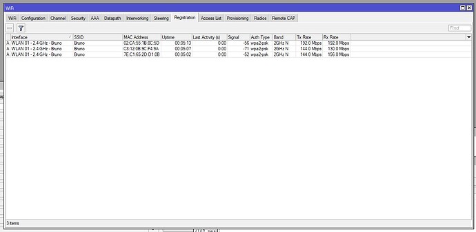

I already tried that some time before, but I’ll give it another try… I will only change the security profile for the ‘Bruno’ SSID as that’s the one that is used by the HP printer on this floor…
After I changed to wp2-psk (only) and ccmp (only) the printer doesn’t even appear at all anymore in the Registration list… So that didn’t solve the problem…

Yep, I only pointed out that the earlier screenshot didn't prove that. :slightly_smiling_face:
