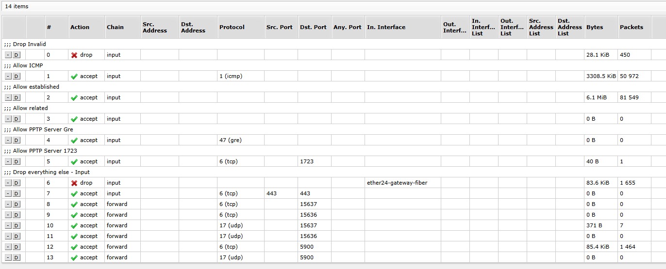

Here is my configuration export:
# mar/05/2025 11:42:19 by RouterOS 6.43.8
# software id = LAH2-21J1
# model = CRS125-24G-1S
# serial number = 5A8C058B7CF7
add admin-mac=E4:8D:8C:81:A8:B7 arp=proxy-arp auto-mac=no fast-forward=no \
    mtu=1500 name=bridge1
set [ find default-name=ether1 ] name=ether01-master-local-vince speed=\
    100Mbps
set [ find default-name=ether2 ] name=ether02-slave-local-vince speed=100Mbps
set [ find default-name=ether3 ] name=ether03-slave-local-kontor speed=\
    100Mbps
set [ find default-name=ether4 ] name=ether04-slave-local-kontor speed=\
    100Mbps
set [ find default-name=ether5 ] name=ether05-slave-local-tvrum speed=100Mbps
set [ find default-name=ether6 ] name=ether06-slave-local-tvrum speed=100Mbps
set [ find default-name=ether7 ] name=ether07-slave-local-joline speed=\
    100Mbps
set [ find default-name=ether8 ] name=ether08-slave-local-joline speed=\
    100Mbps
set [ find default-name=ether9 ] name=ether09-slave-local-vardagsrum speed=\
    100Mbps
set [ find default-name=ether10 ] name=ether10-slave-local-vardagsrum speed=\
    100Mbps
set [ find default-name=ether11 ] name=ether11-slave-local-vardagsrum speed=\
    100Mbps
set [ find default-name=ether12 ] name=ether12-slave-local-vardagsrum speed=\
    100Mbps
set [ find default-name=ether13 ] name=ether13-slave-local-kok speed=100Mbps
set [ find default-name=ether14 ] name=ether14-slave-local-kok speed=100Mbps
set [ find default-name=ether15 ] name=ether15-slave-local-masterbedroom \
    speed=100Mbps
set [ find default-name=ether16 ] name=ether16-slave-local-masterbedroom \
    speed=100Mbps
set [ find default-name=ether17 ] name=ether17-slave-local-server_laptop \
    speed=100Mbps
set [ find default-name=ether18 ] name=ether18-slave-local speed=100Mbps
set [ find default-name=ether19 ] name=ether19-slave-local speed=100Mbps
set [ find default-name=ether20 ] name=ether20-slave-local speed=100Mbps
set [ find default-name=ether21 ] name=ether21-slave-local-garage speed=\
    100Mbps
set [ find default-name=ether22 ] name=ether22-slave-local-garage speed=\
    100Mbps
set [ find default-name=ether23 ] name=ether23-ubiquiti-ap speed=100Mbps
set [ find default-name=ether24 ] name=ether24-gateway-fiber speed=100Mbps
set [ find default-name=sfp1 ] advertise=\
    10M-half,10M-full,100M-half,100M-full,1000M-half,1000M-full name=\
    sfp1-slave-local-NOT-USED
/interface pptp-server
add name=pptp-in1 user=""
/ip ipsec proposal
set [ find default=yes ] enc-algorithms=aes-128-cbc
add name="dhcp range" ranges=192.168.1.161-192.168.1.199
add name=pptp-pool ranges=192.168.1.151-192.168.1.160
add address-pool="dhcp range" authoritative=after-2sec-delay disabled=no \
    interface=bridge1 lease-time=3h name=dhcp1
/ppp profile
add bridge=bridge1 change-tcp-mss=yes local-address=pptp-pool name=\
    PPTP-Profile only-one=yes remote-address=pptp-pool use-encryption=yes
set *FFFFFFFE bridge=bridge1 local-address=pptp-pool remote-address=\
    192.168.1.1
/snmp community
set [ find default=yes ] addresses=0.0.0.0/0
/user group
add name=homeassistant policy="reboot,read,write,policy,test,api,!local,!telne\
    t,!ssh,!ftp,!winbox,!password,!web,!sniff,!sensitive,!romon,!dude,!tikapp"
add bridge=bridge1 interface=ether01-master-local-vince
add bridge=bridge1 interface=ether02-slave-local-vince
add bridge=bridge1 interface=ether03-slave-local-kontor
add bridge=bridge1 interface=ether04-slave-local-kontor
add bridge=bridge1 interface=ether05-slave-local-tvrum
add bridge=bridge1 interface=ether06-slave-local-tvrum
add bridge=bridge1 interface=ether07-slave-local-joline
add bridge=bridge1 interface=ether08-slave-local-joline
add bridge=bridge1 interface=ether09-slave-local-vardagsrum
add bridge=bridge1 interface=ether10-slave-local-vardagsrum
add bridge=bridge1 interface=ether11-slave-local-vardagsrum
add bridge=bridge1 interface=ether12-slave-local-vardagsrum
add bridge=bridge1 interface=ether13-slave-local-kok
add bridge=bridge1 interface=ether14-slave-local-kok
add bridge=bridge1 interface=ether15-slave-local-masterbedroom
add bridge=bridge1 interface=ether16-slave-local-masterbedroom
add bridge=bridge1 interface=ether17-slave-local-server_laptop
add bridge=bridge1 interface=ether18-slave-local
add bridge=bridge1 interface=ether19-slave-local
add bridge=bridge1 interface=ether20-slave-local
add bridge=bridge1 interface=ether21-slave-local-garage
add bridge=bridge1 interface=ether22-slave-local-garage
add bridge=bridge1 interface=ether23-ubiquiti-ap
add bridge=bridge1 interface=sfp1-slave-local-NOT-USED
/interface ovpn-server server
set auth=sha1 certificate=server cipher=aes256 enabled=yes \
    require-client-certificate=yes
/interface pptp-server server
set authentication=pap,chap,mschap1,mschap2 enabled=yes
add address=192.168.1.1/24 interface=ether01-master-local-vince network=\
    192.168.1.0
/ip dhcp-client
add dhcp-options=hostname,clientid disabled=no interface=\
add dhcp-options=hostname,clientid interface=ether01-master-local-vince
/ip dhcp-server lease
add address=192.168.1.2 client-id=1:4:18:d6:d0:55:83 comment=ACCESSPUNKT \
    mac-address=04:18:D6:D0:55:83 server=dhcp1
add address=192.168.1.52 client-id=1:0:1d:ec:8:ce:4c mac-address=\
    00:1D:EC:08:CE:4C server=dhcp1
add address=192.168.1.51 client-id=1:0:1d:ec:a:52:b2 mac-address=\
    00:1D:EC:0A:52:B2 server=dhcp1
add address=192.168.1.111 client-id=1:28:cf:da:2a:d8:97 comment="APPLE TV" \
    mac-address=28:CF:DA:2A:D8:97 server=dhcp1
add address=192.168.1.31 client-id=1:f0:b4:79:6:0:db comment=\
    "AIRPORT EXPRESS" mac-address=F0:B4:79:06:00:DB server=dhcp1
add address=192.168.1.112 client-id=1:98:d6:bb:1c:30:36 mac-address=\
    98:D6:BB:1C:30:36 server=dhcp1
add address=192.168.1.101 client-id=1:8c:2d:aa:4a:1e:c7 mac-address=\
    8C:2D:AA:4A:1E:C7 server=dhcp1
add address=192.168.1.42 client-id=1:cc:f7:35:e2:ed:56 mac-address=\
    CC:F7:35:E2:ED:56 server=dhcp1
add address=192.168.1.41 comment="AMAZON ECHO" mac-address=44:00:49:4A:6C:C0 \
    server=dhcp1
add address=192.168.1.50 client-id=1:70:2a:d5:ec:39:de comment=\
    "DIGITALBOXAR & TV" mac-address=70:2A:D5:EC:39:DE server=dhcp1
add address=192.168.1.102 client-id=1:c8:63:f1:f9:25:aa mac-address=\
    C8:63:F1:F9:25:AA server=dhcp1
add address=192.168.1.100 client-id=1:d0:17:c2:d4:84:e0 comment="PC & IMAC" \
    mac-address=D0:17:C2:D4:84:E0 server=dhcp1
add address=192.168.1.201 comment=SHELLY mac-address=CC:50:E3:1D:9C:6F \
    server=dhcp1
add address=192.168.1.105 mac-address=00:23:C1:0D:BA:8A server=dhcp1
add address=192.168.1.122 client-id=1:30:10:e4:6c:ef:cf mac-address=\
    30:10:E4:6C:EF:CF server=dhcp1
add address=192.168.1.202 mac-address=84:F3:EB:E2:C6:E4 server=dhcp1
add address=192.168.1.104 mac-address=50:EC:50:04:72:08 server=dhcp1
add address=192.168.1.44 client-id=1:44:0:49:9e:55:bd mac-address=\
    44:00:49:9E:55:BD server=dhcp1
add address=192.168.1.43 client-id=1:3c:5c:c4:ca:e8:da mac-address=\
    3C:5C:C4:CA:E8:DA server=dhcp1
add address=192.168.1.45 client-id=1:3c:5c:c4:5a:e5:72 mac-address=\
    3C:5C:C4:5A:E5:72 server=dhcp1
add address=192.168.1.4 client-id=1:b8:27:eb:e0:c4:19 comment=\
    "NIBE F1245 - BERGV\C4RMEPUMP" mac-address=B8:27:EB:E0:C4:19 server=dhcp1
add address=192.168.1.204 mac-address=84:F3:EB:E2:C9:FB server=dhcp1
add address=192.168.1.203 mac-address=84:F3:EB:E2:00:79 server=dhcp1
add address=192.168.1.3 client-id=1:80:2a:a8:40:3a:22 mac-address=\
    80:2A:A8:40:3A:22 server=dhcp1
add address=192.168.1.120 client-id=1:8a:80:41:59:82:8b comment=\
    "\D6VRIGA ENHETER" mac-address=8A:80:41:59:82:8B server=dhcp1
add address=192.168.1.21 client-id=1:da:9b:90:45:17:fc mac-address=\
    DA:9B:90:45:17:FC server=dhcp1
add address=192.168.1.121 client-id=1:66:d4:7d:1a:e3:ae mac-address=\
    66:D4:7D:1A:E3:AE server=dhcp1
add address=192.168.1.11 client-id=\
    ff:ca:53:9:5a:0:2:0:0:ab:11:3:64:da:69:79:f6:af:95 mac-address=\
    BE:E4:64:99:C6:06 server=dhcp1
add address=192.168.1.15 client-id=1:0:11:32:7a:e4:52 mac-address=\
    00:11:32:7A:E4:52 server=dhcp1
add address=192.168.1.6 mac-address=4C:EB:D6:59:11:6C server=dhcp1
add address=192.168.1.208 mac-address=C4:5B:BE:E4:4B:DB server=dhcp1
add address=192.168.1.205 mac-address=48:55:19:02:B6:F0 server=dhcp1
add address=192.168.1.206 mac-address=98:CD:AC:13:18:7E server=dhcp1
add address=192.168.1.207 mac-address=E8:DB:84:D3:00:F0 server=dhcp1
add address=192.168.1.5 client-id=1:58:ae:a8:b4:97:18 mac-address=\
    58:AE:A8:B4:97:18 server=dhcp1
add address=192.168.1.12 client-id=1:b4:45:6:2a:81:b3 mac-address=\
    B4:45:06:2A:81:B3 server=dhcp1
add address=192.168.1.199 client-id=1:cc:15:31:35:5c:4b mac-address=\
    CC:15:31:35:5C:4B server=dhcp1
add address=192.168.1.0/24 dns-server=192.168.1.1,8.8.8.8 domain=local \
    gateway=192.168.1.1 netmask=24
set allow-remote-requests=yes servers=192.168.1.1

No firewall rules???

I do have firewall rules… But if it is enough, I cant say. :astonished:

Overall (and mind you this is just my opiinion, man) your “needed” configuration appears to be somehow hiding below several layers of cruft deriving from leftovers from tests/old settings and what not, it is very difficult from the outside to understand (sometimes guess) which parts are needed and which parts are just leftovers (that may only represent a visual complucation or actually prevent somethign else from working correectly).
IMHO it would be much easier if you would enumerate what you actually need, then restart from a reset configuration and re-add only what is actually needed, for two reasons, the first to make sure that there is nothing compromising the working of the device, the second to make the whole stuff simpler, more readable and thus easier to mantain/change/fine tune-
