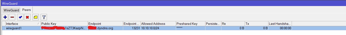

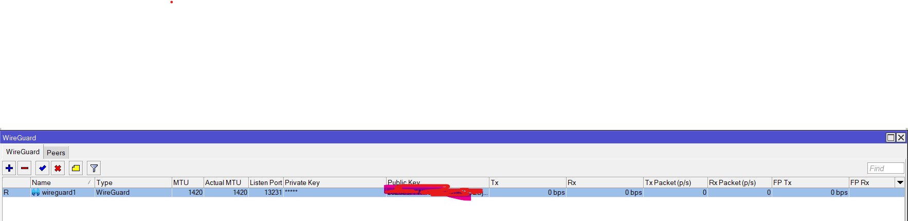

I have this on the router:

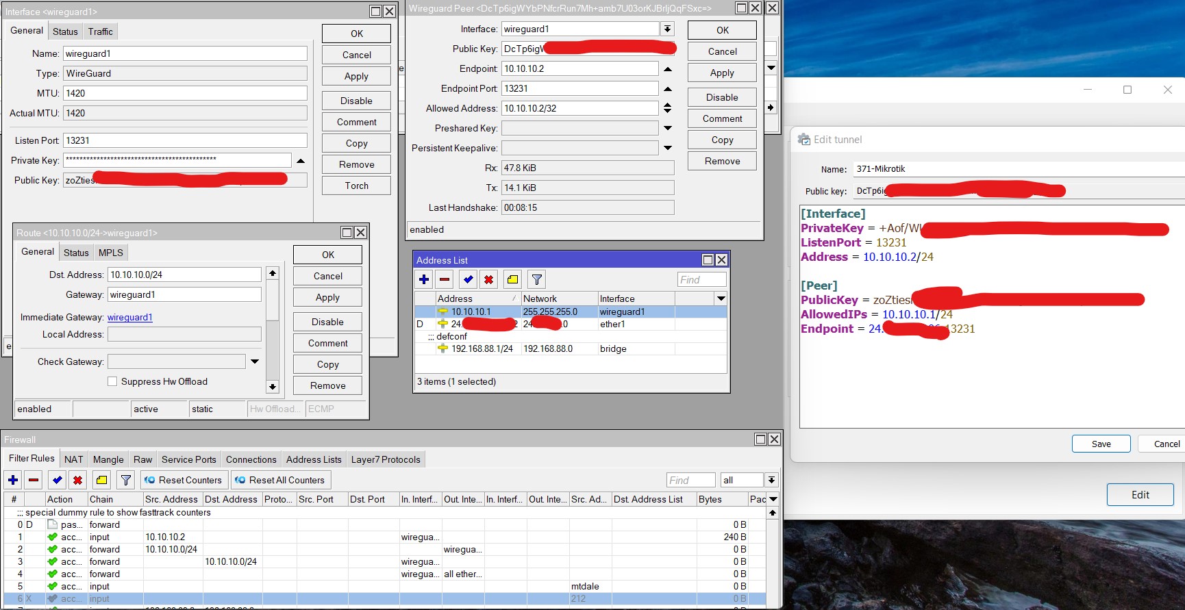

Many, many hours later… I think I got it working (not 100% certain).
Here are the details of my config – I left the first bunch of characters for the keys so readers can see which keys go where (I know, I know, it would be much better to have a deep and true understanding of why and how).
I don’t know why the only firewall traffic is for the INPUT rule, and not the FORWARD rules, but it seems to work.
How did I do?
You have censored public key on last image, and not the private…
Thank you!
I posted too soon.
I thought it was working, but it’s not.
From the router, I can ping 10.10.10.2 (Windows Wireguard interface IP).
But, I can’t ping 10.10.10.1 from Windows.
Nor can I ping from Windows anything connected to the router.

An interesting piece of information:
A ping initiated on my Windows PC to 10.10.10.1 (router’s IP) fails UNLESS I first initiate a ping from the router to 10.10.10.2 (Windows PC) (which works), and then .1 to .2 will work.
Like the “established session” firewall is allowing it maybe?
