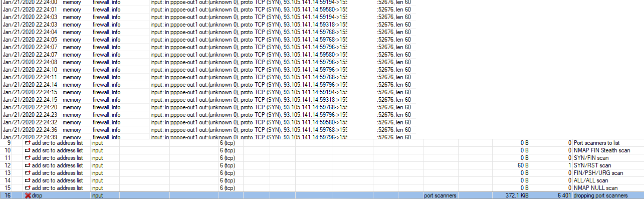

My public IP is getting raped by port scanners - is that normal?
I am using MT devices around year now and I like to check my main router logs from time to time. There was always some port scanner entries from Firewall, some IP scanned few ports and disappeared for some time. Sometimes there were 3-4 different scanning source IPs per day, sometimes there was 2-3 days of no scaning at all. However since I upgraded to 6.46.2 (may be just coincidence) two days ago 99% of my log is port scanner running all the time.Is that normal? Should I be worrying?

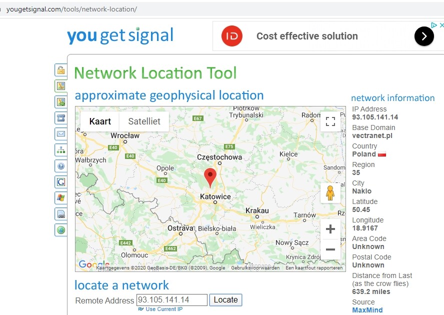

Address: 93.105.141.14
I’m wondering why some attacker (or “attacker”?) would banging on a seemingly random TCP port number, such as 52676?
That IP address returns the following:

You can send them an email and find out why they are scanning your system – assuming they will respond to your query.
BTW That IP Address may be a QNAP server http://93.105.141.14:8080/cgi-bin/

From log we can see that something behind this static address tries to connect to address 155.x.y.x port 52676

You should DROP all unknown traffic on input chain, and especially not log (easy to exhaust the router with a tiny flood). Your current rules that add to address lists (which you then presumably drop) also open you to attacks by an IP spoofing attacker.

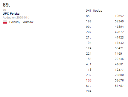

I didn’t read this thread closely and there’s already been some good suggestions - but is your external IP on Shodan? You don’t need a logon or API key to check for one IP on their site. https://www.shodan.io/search?query= and type in your external IP at the end of the link. Once I saw activity from external hosts trying to use my proxy server. They couldn’t actually use it because of the firewall, but obviously I had to shut that down. They had identified my router as Mikrotik because I’d neglected to disable the BTest server running by default on port 2000. I disabled that, moved my proxy off the bastion router, and I wasn’t on Shodan anymore. Just thought it was worth mentioning :slight_smile:
I checked shodan and I am listed there with that port 52676 - what does it mean? Where did it came from? Entry was added there yesterday, but I am getting flooded since 3 days - just when I did upgrade to 6.46.2 from 6.46.

Came back home and studied Shodan a bit more.
If I understand correctly I am added there not as “host”, but as comment to other host entry:
I checked Deluge running on my raspberry pi and indeed it used 52676 port during current session.
So if my thinking is correct then some compromised system/machine extracted DHT list from itself and I was listed there amongst other nodes.
