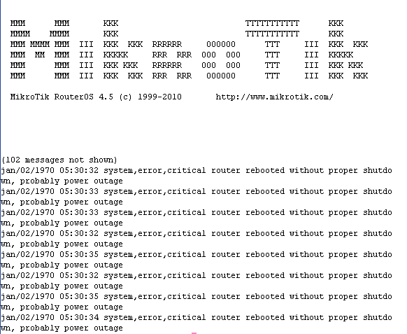

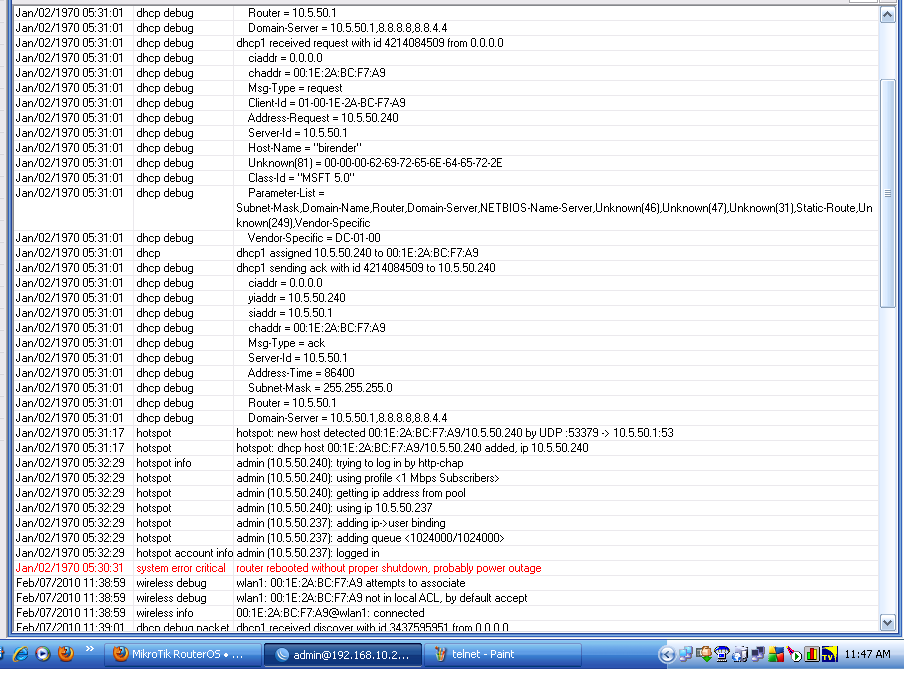

my RB433AH get restarted automatically within few seconds

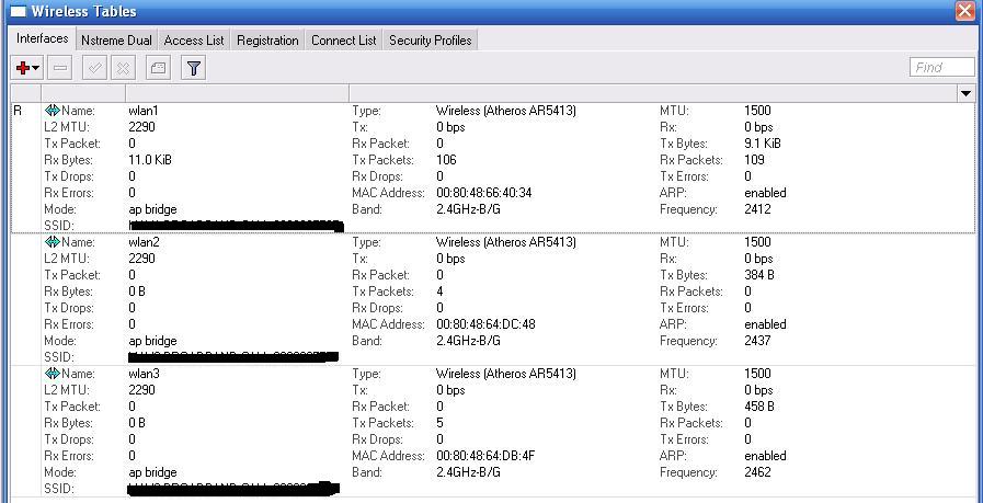

I have RS433AH and it got restarted automatically when any wireless client connects the connection is not stable.
I try to change the channels also but same problem why this happened.
any technical fault…? its loaded with 4.5 updated…
please give some solution to this problem…

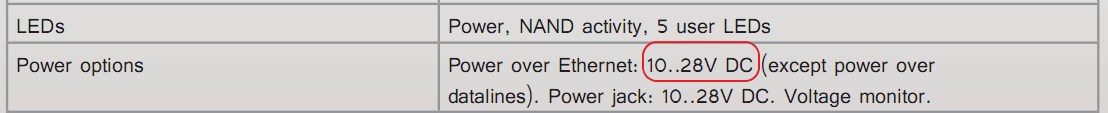

I would suspect the power supply. Are you using a power supply capable of supplying the correct voltage and current? Sounds like when the wireless card starts transmitting, it draws enough current to drop the input voltage below 10 volts.
I would remove the wireless card and boot the router. Then check
/system health print
See if the input voltage is close to 10 volts.
ADD: I just got a new R52Hn radio, and the data sheet shows it uses almost twice the power (7W) of my 433 (4W) when transmitting in n-mode. Your “/interface wireless” setup shows you have 3 radios.

I am from india and we have 220 to 240 volts supply i have 48 volts PoE injector which supply power to RB433AH.
