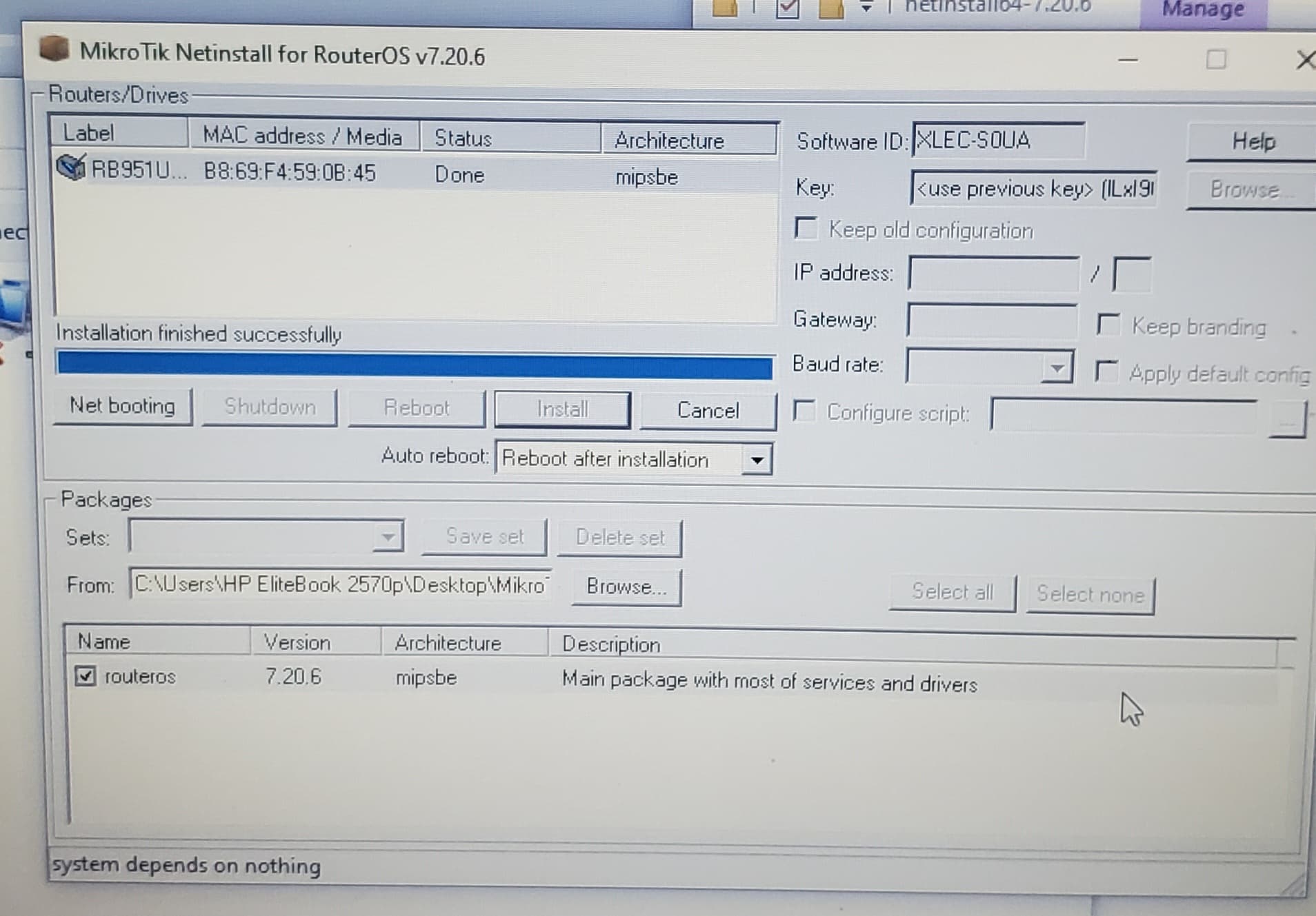

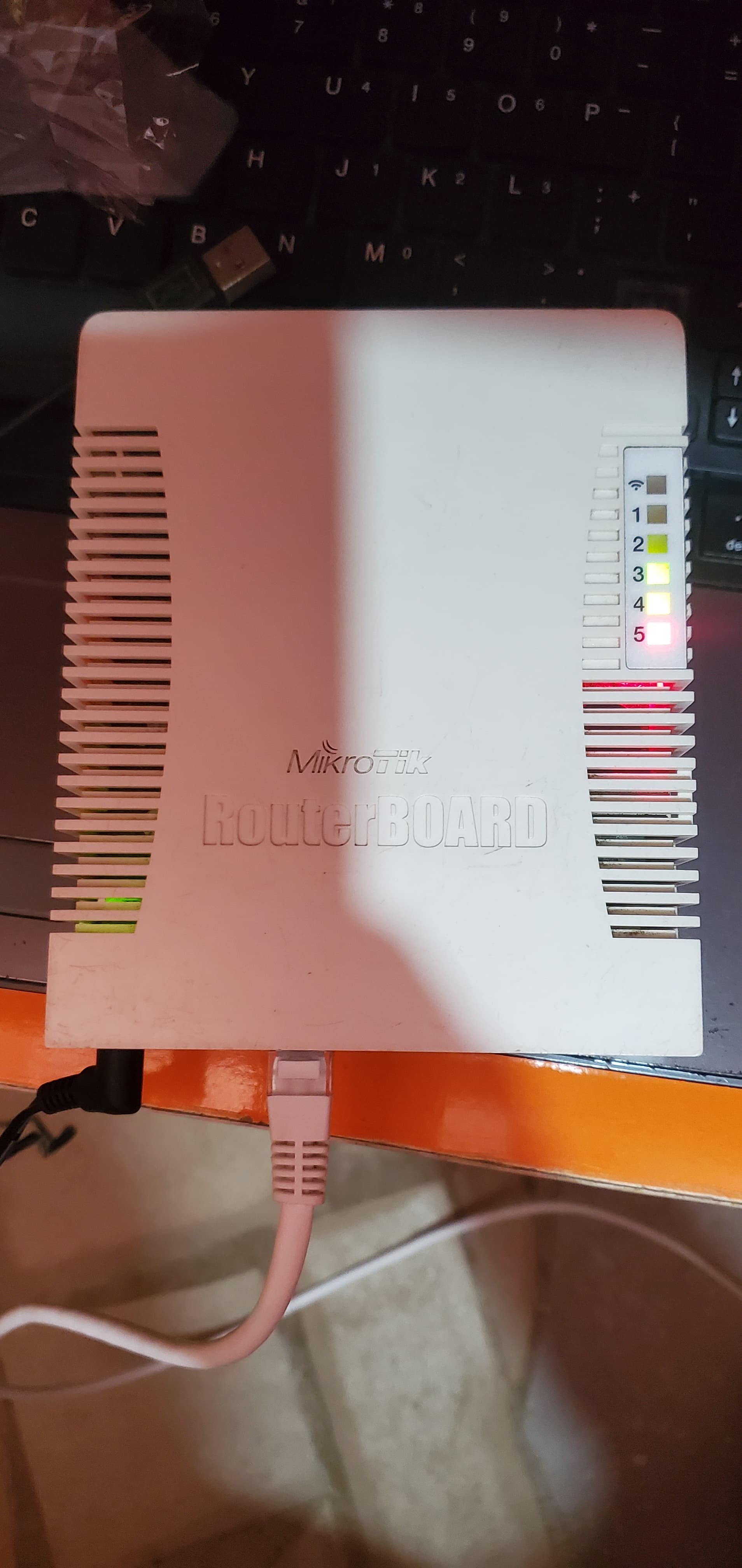

i kept my router for two weeks without use, now i bring it out for use while i noticed it only blink 4 & 5 light.
i tried to restore it went successfully but still not come up.

Also, which LEDs are 4&5? ![]()

Please check “apply default config”
If doing netinstall with ROS7, you also need wireless or the next complaint will be that wifi doesn't work.
Why not use latest ROS6 for that device ?
sir, it doesn’t connect to winbox and just continue flash 4&5 light….
i have used ROS6 also, but not working still.

Sir, as you can see I my provided above image, it only blink led light and go off immediately when I plug to power.
