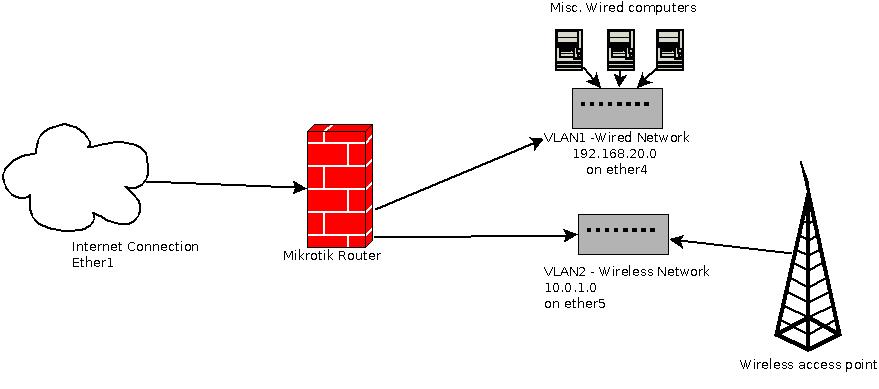

ok here’s a quick diagram
You don’t need vlans for that at all. Just run each port as its own network and block cross traffic with the firewall.
Sent from my SCH-I545 using Tapatalk
Yes, VLANs are needed for this setup. I’m not getting into why or who says so, they need to be in place.
No, they are useless in your setup. You just have different ports with different networks.
Your firewall rules should prevent inter range communication.
Vlan’s come into the picture when different networks need to be spread over several devices.
Based on your diagram one thing isn’t clear. I assume that the devices on each network don’t understand VLANs correct? e.g. ether ports 4 and 5 should be access ports and not trunk ports?
Even if the connected devices are Vlan aware, it makes no sense using them. It won’t give additional functionality or security.
Oh yeah. I completely agree with that, but the whole trunk port vs access port certainly doesn’t help make it at least functional. I entirely agree that VLANs offer no benefit here.
