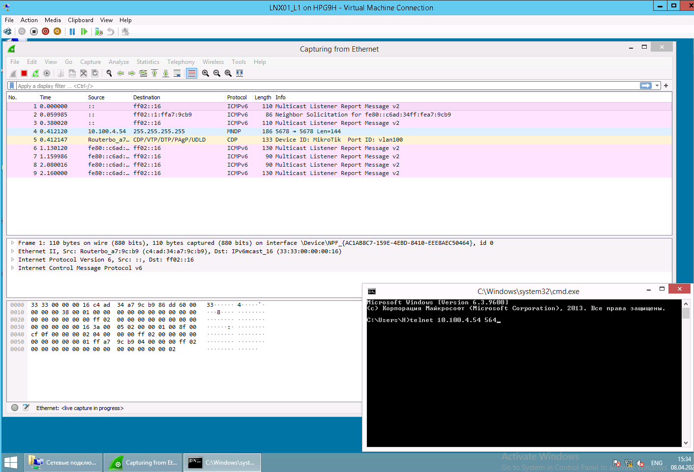

Did you establish a telnet session using TCP 564 ?
Under IP services, what port does it say near the telnet service ?
Yes
An a black screen with symbols i enter by keyboard
sometimes connection lost after a few symbols
sometimes not

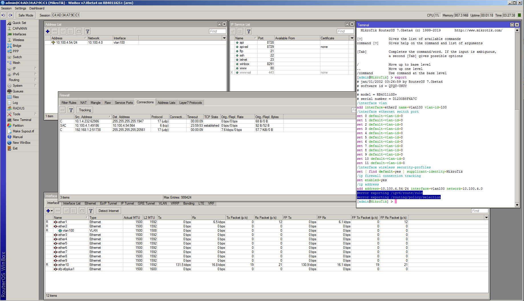

Whole configuration
[admin@MikroTik] > export
jan/01/2002 05:07:05 by RouterOS 7.0beta5
software id = QTQU-UNUY
model = RB4011iGS+
serial number = serial
set [ find default-name=ether1 ] name=ether1_WAN
/interface vlan
add interface=ether1_WAN name=“44 WAN” vlan-id=44
set 0 default-vlan-id=0
set 1 default-vlan-id=0
set 2 default-vlan-id=0
set 3 default-vlan-id=0
set 4 default-vlan-id=0
set 5 default-vlan-id=0
set 6 default-vlan-id=0
set 7 default-vlan-id=0
set 8 default-vlan-id=0
set 9 default-vlan-id=0
set 10 default-vlan-id=0
set 11 default-vlan-id=0
/ipv6 settings
set disable-ipv6=yes
add address=realip/27 comment=BeeLine interface=“44 WAN” network=realip
add action=accept chain=input dst-port=564 log=yes log-prefix=564_ protocol=tcp
/ip service
set www-ssl disabled=no
#error exporting /ipv6/route/rule
#error exporting /routing/policy/selection
I can provide You full access

If you execute a packet capture for 564/tcp on either the router, client or middle device in the path. Does the contents for the packets reveal anything?

Wow, suddenly I found an Attachments button on forum
so, my trouble in attace
no, or I can’t enterpretate it
