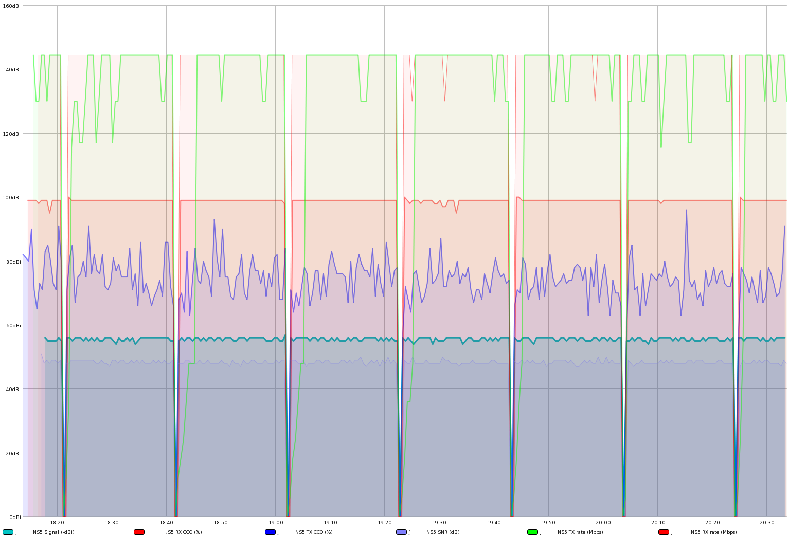

Hi, I switch from old RB600 and MC9 carts to AP base on RB921GS-5HPacD r2. From that moment NanoStations M5 as clients start disconecting very regulary - every 20mins for 1minute and connect again. Signal from AP is -57 dBm and CCQ 99%, signal from client bit weeked 56-60dBm and CCQ 80-99%
Any idea what it can be?
I did try change default falue of Disconnect Timeout on wireless interface on AP from 3s to 7sec but not much different. I did changefq also but same result. Other Mikrotik based clients are fine on same AP.

Solved. Nanostation has watchdog. Interval 300s, startup delay 300s, Failure Count To Reboot: 3 = reboot every 20minutes :slight_smile:)). I was pinging old, not existed gateway :frowning:
