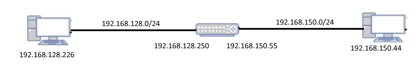

New to MikroTik and router in general, below is a diagram of two different subnets, I would like to configure the router in between where the 192.168.128.0/24 network can obtain information from the 192.168.150.0/24 network. Knowing that I can configure the router with static routes between the subnets. I do however trying to minimize any devices configuration changes to the 192.168.150.0/24 network, namely not wanting programming in the default gateway into existing devices. How would I go by setting NAT 1:1 with the MikroTik hEX lite?

192.168.128.226 is needing information from 192.168.150.44, thinking that with 1:1 NAT, 192.168.128.226 should be able to request information from 192.168.150.44 via 192.168.128.44.
Trued to configure 1:1 NAT with the following commands and it did not work, need some tips and tricks to troubleshoot.
/ip firewall nat add chain=dstnat dst-address=192.168.128.226
action=netmap to-addresses=192.168.150.44
/ip firewall nat add chain=srcnat src-address=192.168.150.44
action=netmap to-addresses=192.168.128.226

The scenario that we are currently in, all of the devices are non-PCs that utilize static IPs with no initial gateway address programmed in them. To re-program all of the non-PCs devices would likely cost the loss of production. My understanding is 1:1 NAT will work, but just need advice on the command syntax, and 1:1 NAT troubleshooting tips.

Referencing: https://wiki.mikrotik.com/wiki/Manual:IP/Firewall/NAT, It seems that 1:1 NAT Mapping would work for MT. Just need to know what else is missing, please elaborate on the why 1:1 NAT would not work. Is it a hardware, or configurations limitations?

Based on what you shared: all you want is connect from .128. ip to .150. ip. For that normal routing would suffice, since .128. systems have proper gateway. (1)
.150. systems don’t have gateway set, so you’ll need to communicate with an ip in their range, and one which can relay responses back: router’s ip => src-nat (2)
(1) + (2) = src-nat != nat 1:1
In other words, if 192.168.128.226 uses 192.168.128.250 as its default gateway, and 192.168.128.226 will initiate connections to 192.168.150.44 (not the other way), then all you need is:
add chain=srcnat out-interface=<interface connected to .150 network> action=masquerade
In case even 192.168.128.226 doesn’t have this router as default gateway, you can add:
add chain=dstnat dst-address=192.168.128.250 action=netmap to-addresses=192.168.150.44
Then if you connect to 192.168.128.250, router will forward packets to 192.168.150.44.
If you need this for multiple devices in .150 network, then add additional “virtual” addresses:
add address=192.168.128.44/24 interface=<same interface where 192.168.128.250 is>
add address=192.168.128.45/24 interface=<same interface where 192.168.128.250 is>
add chain=dstnat dst-address=192.168.128.44 action=netmap to-addresses=192.168.150.44
add chain=dstnat dst-address=192.168.128.45 action=netmap to-addresses=192.168.150.45
It works, thanks all for being patient with me.
