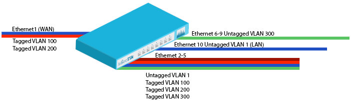

I’m quite new to the MikroTik/RouterOS world and I have the following problem.
Right now I have network of managed switches that handle multiple VLANs and I want to replace one of the main switches with a MikroTick router. The picture attached shows how I see the VLANs distribution on the router (and it is also what I already have on the managed switch).
This part I’ve already figured it out using the VLAN Example #1 (Trunk and Access Ports) from https://wiki.mikrotik.com/wiki/Manual:Interface/Bridge
The part I’m trying to figure out, if it is possible to be done, is this one - I have a /24 public IP class is routed on VLAN 100 and I want to add a WAN interface on this VLAN with one of the IPs, then add a LAN class to the router that is NATed trough this WAN interface and make it available via VLAN 1 (default). At the same time the VLAN 100 needs to be forwarded to some of ports along side VLAN 200 (another /24 public IPs class) and VLAN 300 that is local (all VLANs are tagged on the ports that are shared with the exception of VLAN 1)
Any hints are greatly appreciated.
