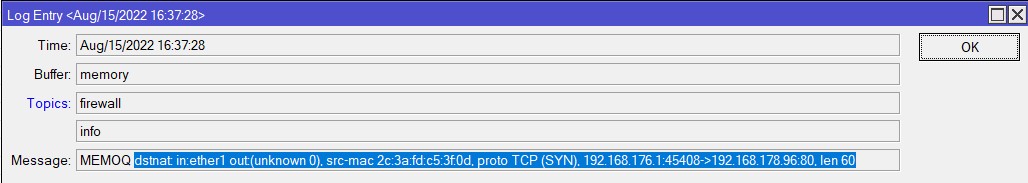

One thing I noticed is that I get the following NAT behaviour
where SYN messages are sent to ip adresses that aren’t in use. Starting from lets say x.x.x.98 going to x.x.x.107 .
Is this behaviour expected? Let me know which configuration details you need.

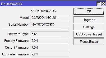

Also while looking for the version number of RouterOS I got the following:
which looks as though I haven’t upgraded RouterOS but I am pretty sure I did this already.

7.2.1 is rather old, and by the screenshot provided it looks you didn’t upgrade the firmware (from the RouterBOARD menu, the exact one you’ve posted).
