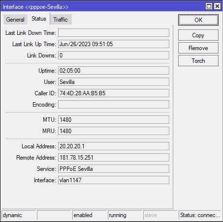

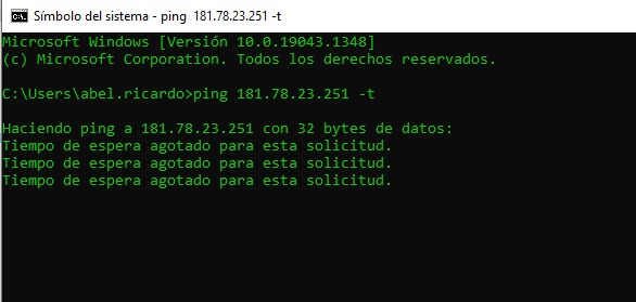

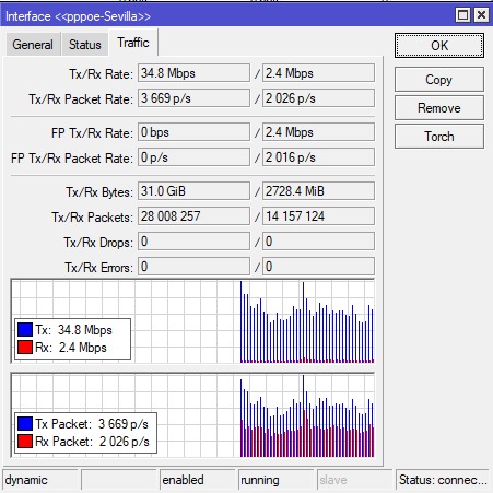

Hello…I provide internet to a client by PPPoE with a Public IP (181.78.15.181), however currently the client has internet but the IP does not respond to PING from outside the network.
C:\Users\abel.ricardo>ping 181.78.15.251
Haciendo ping a 181.78.15.251 con 32 bytes de datos:
Tiempo de espera agotado para esta solicitud.
Estadísticas de ping para 181.78.15.251:
Paquetes: enviados = 4, recibidos = 0, perdidos = 4
(100% perdidos),
The service is currently operational, but I have no reach of the Public IP from an external network. I want to know what causes this behavior
