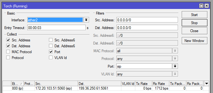

If I Torch the external interface for SIP port traffic, there is only a Tx Rate, no Rx Rate. So it would seem the SIP traffic is not bi-directional.

OK - but can you see that the IP traffic has been src NATed outbound? If there is no return traffic at all then it sounds as if the target host is never responding.
I’ve attached screen shots of the Firewall-Connections screen and the Torch results. Do these help you understand what is happening?

If possible I suggest that you check if these phones register when connected via some other connection. There appears to be no return traffic from the SIP server. It would be useful to know if they register when connected elsewhere in case the problem is not RouterOS related.
That has been tested. Both devices have been taken to another network and both provision, register, and work perfectly.
Have another look with torch and show the IP numbers. Perhaps there is something wrong with the traffic leaving such that it cannot be returned by the SIP server.
New Torch screenshots attached.
Have a look without the 3 second timeout - try say 30/60 seconds. It still looks as if there is no return traffic from the SIP server.
