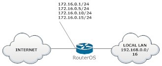

I attach you a layout of network.
Please, consider, 172.16.0.0/24 public ip addresses.
I disabled firewall on router os and now I have only this configuration:
ip firewall nat add chain=srcnat src-address=192.168.0.1 action=src-nat to-addresses=“172.16.0.1”
ip firewall nat add chain=dstnat dst-address=“172.16.0.1” action=dst-nat to-addresses=192.168.0.1
ip firewall nat add chain=srcnat src-address=192.168.0.2 action=src-nat to-addresses=“172.16.0.5”
ip firewall nat add chain=dstnat dst-address=“172.16.0.5” action=dst-nat to-addresses=192.168.0.2
etc …

Go back to the configuration you want to run. Then post it - so far you’ve only been showing snippets. That would include the output of “/ip address print detail”, “/ip route print detail”, “/interface print detail”, “/ip firewall export”, and a network diagram.
This is the configuration. The firewall is disabled… I only posted nat table …
The network in ip route are unrecheable beacause I disattached the router … and another think … I replaced my ip public with 172.16.0.0/24 …
I would to remember you that if I active only one ip address for example 172.16.0.5 the nat, source and destination, run correctly… I have problem if add another ip to the same interface…
 1   address=172.16.0.1/24 network=172.16.0.0 interface=ether9 actual-interface=ether9
 2   address=172.16.0.5/24 network=172.16.0.0 interface=ether9 actual-interface=ether9
 3   address=172.16.0.10/24 network=172.16.0.0 interface=ether9 actual-interface=ether9
 4   address=172.16.0.15/24 network=172.16.0.0 interface=ether9 actual-interface=ether9
0   S  dst-address=0.0.0.0/0 gateway=172.16.0.254 gateway-status=172.16.0.254 unreachable distance=1 scope=30 target-scope=10
 1 ADC  dst-address=172.16.0.0/24 pref-src=172.16.0.1 gateway=ether9 gateway-status=ether9 unreachable distance=0 scope=200
 3 ADC  dst-address=192.168.0.0/16 pref-src=192.168.255.254 gateway=ether8 gateway-status=ether8 unreachable distance=0 scope=200
 0  R  name="ether10" type="ether" mtu=1500 l2mtu=1600 max-l2mtu=9116
 1     name="ether9" type="ether" mtu=1500 l2mtu=1500 max-l2mtu=9116
 2     name="ether7" type="ether" mtu=1500 l2mtu=1600 max-l2mtu=4080
 3     name="ether8" type="ether" mtu=1500 l2mtu=1500 max-l2mtu=4080
 4     name="ether6" type="ether" mtu=1500 l2mtu=1600 max-l2mtu=4080
 5     name="ether5" type="ether" mtu=1500 l2mtu=1598 max-l2mtu=4078
 6     name="ether4" type="ether" mtu=1500 l2mtu=1598 max-l2mtu=4078
 7     name="ether3" type="ether" mtu=1500 l2mtu=1598 max-l2mtu=4078
 8     name="ether2" type="ether" mtu=1500 l2mtu=1598 max-l2mtu=4078
 9     name="ether1" type="ether" mtu=1500 l2mtu=1598 max-l2mtu=4078
/ip firewall nat export
add action=src-nat chain=srcnat comment="192.168.0.1 (SOURCE NATTING)" disabled=no src-address=192.168.0.1 to-addresses=172.16.0.5
add action=dst-nat chain=dstnat comment="192.168.0.1 (DESTINATION NATTING)" disabled=no dst-address=172.16.0.5 to-addresses=192.168.0.1
add action=src-nat chain=srcnat comment="192.168.0.2 (SOURCE NATTING)" disabled=no src-address=192.168.0.2 to-addresses=172.16.0.10
add action=dst-nat chain=dstnat comment="192.168.0.2 (DESTINATION NATTING)" disabled=no dst-address=172.16.0.10 to-addresses=192.168.0.2
add action=src-nat chain=srcnat comment="192.168.0.3 (SOURCE NATTING)" disabled=no src-address=192.168.0.3 to-addresses=172.16.0.15
add action=dst-nat chain=dstnat comment="192.168.0.3 (DESTINATION NATTING)" disabled=no dst-address=172.16.0.15 to-addresses=192.168.0.3
add action=netmap chain=srcnat comment="ROUTER OS (SOURCE NAT)" disabled=no to-addresses=172.16.0.1
