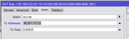

I have a dynamic address and I could not find how to set the dynamic IP in the rule for src-nat.
Here are the rules :
add action=dst-nat chain=dstnat comment=NAS dst-address-type=local dst-port=
25,110,143,993,995,80,443,5000-5006,6690,7001 protocol=tcp to-addresses=
192.168.0.22 to-ports=25-7001
add action=src-nat chain=srcnat dst-address=192.168.0.22 dst-port=
96.20.106.43 to-ports=0-65535
I’m using a dyndns script, working fine and I get ‘current_ip’ variable I can use in the Address List, but I don’t know how to do with src-nat for the “To Addresses” (support only IP address). Any Idea?

See picture. How to replace “To Addresses” by dynamic IP?

I have a small NAS server in the house with different services and DynDns script working fine. I can use ‘current_IP’ from DynDns for the address List (Dst or Dst).
I would like to make available my server from outside, but also on the loacal network using the dns (this is why this rule, but I am perhaps wrong).

The NAS has his own local static IP. On the NAS, we have different services like file server, camera server, email server, Photo album, etc… Each service use a different ports (25,110,143,993,995,80,443,5000-5006,6690,7001) to be reachable from outside, on the same public IP, through the NAT. “current_IP” is generated by the DynDNS script as a global variable and is the external public IP.
PS: The 2 first rules in the first msg. works perfectly, except when the IP change :
add action=dst-nat chain=dstnat comment=NAS dst-address-list=current_IP
dst-port=25,110,143,993,995,80,443,5000-5006,6690,7001 protocol=tcp to-addresses=192.168.0.22 to-ports=25-7001
add action=src-nat chain=srcnat dst-address=192.168.0.22 dst-port=25,110,143,993,995,80,443,5000-5006,6690,7001
protocol=tcp to-addresses=123.45.678.90 to-ports=25-7001
