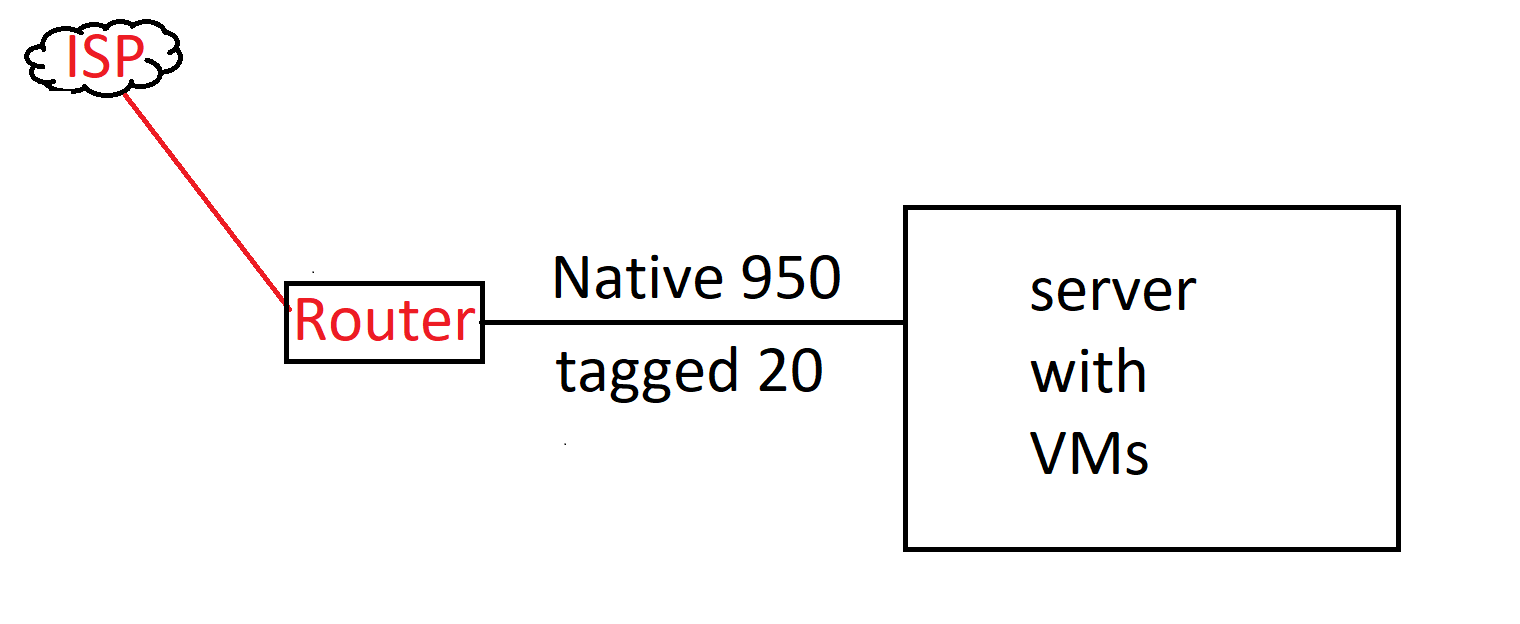

I need to do that :
konfig.rsc (2.7 KB)
but I can’t - any of

I need to do that :
konfig.rsc (2.7 KB)

Try to look at this:
https://wiki.mikrotik.com/wiki/Manual:Interface/Bridge#Bridge_VLAN_Filtering
and following examples. Because what you’re trying to do now does not make any sense at all.
What you are looking for is called hybrid vlan, see:
Except if your hardware is CRS https://wiki.mikrotik.com/wiki/Manual:CRS1xx/2xx_series_switches_examples .
And the shame goes once again to Mikrotik for not having notice headers in their wiki articles… https://wiki.mikrotik.com/wiki/Manual:CRS_Router
And the much to little emphasized note of: “VLAN Hybrid ports which can forward both tagged and untagged traffic are supported only by some Gigabit switch chips (QCA8337, Atheros8327)”
Which presumably is why:
No wiki article describe howto setup hybrid ports with native untagged traffic, all the examples translate untagged traffic to a PVID of > 1 while even in their documentation they cannot decide whether untagged should be indicated by PVID 0 or PVID 1 (customer-vid=0). https://networkengineering.stackexchange.com/questions/24404/vlan-0-1-and-4095-are-reserved-what-are-they-reserved-for
