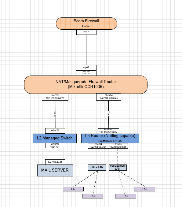

Hi I have a small natting problem
I’ve been trying for ages to sort this hairpin NAT, my mail server is sitting behind a DMZ switch and I can access it externally from another ISP, but can’t see it from inside our network.
For this example:
Vlan 205 is my WAN access
1.1.1.1 is my WAN IP
192.168.20.65 is my mail server IP
add action=masquerade chain=srcnat comment=“Natting Incoming” out-interface=“Vlan 205”
add action=masquerade chain=srcnat comment=“Hairpin NAT” dst-address= 192.168.0.0/16 src-address=192.168.0.0/16 out-interface=ether04
add action=dst-nat chain=dstnat comment=“HTTP/SSL” dst-address=1.1.1.1 dst-address-type=“local” dst-port=443 protocol=tcp to-addresses=192.168.20.65 to-ports=443
Any help appreciated, thank you!
Here’s my network
add action=masquerade chain=srcnat comment="Hairpin NAT" dst-address= 192.168.0.0/16 src-address=192.168.0.0/16 out-interface=ether04
You want to be natting traffic going out vlan704 to the server coming from ether04, so that the source gets changed to the router’s IP. That will cause replies from the server to go via the router, which should then undo the masquerade.
Edit, just another note. If you want to be able to access the server via its lan address without triggering any nat, but also handle the hairpin nat, you may be better off using a mangle rule to flag packets coming from 192.168.0.0/16 to 1.1.1.1, then apply a masq nat rule to those packets when going out the server vlan.
You need to remove the “out-interface” from your hairpin rule. The traffic won’t actually go out if you’re NAT’ing it back in.

I’ve just re-read your diagram and initial post. As you are running 2 separate networks on independent IP ranges you probably don’t need hairpin NAT in the way that my video implies.
If your port forwards have an “in-interface” then that will be what is tripping you up as you aren’t going in through an “in-interface” coming from your network.

I can access the mail server through the local IP of the mail server 192.168.20.65 through ether04 and also from the DMZ. I can access the mail server from an external source i.e a different ISP using the Public IP. When I try to connect to 1.1.1.1:443 it just times out
Thanks again for yer help
Using a hairpin in its basic format, maybe something like this? Although I would point out that in your diagram you have listed VLAN704 with IP 192.168.20.64/28 which is the network address so I’m not sure if that may be affecting you? Either way try masquerading your /24 at your /28 as theoretically that shouldn’t cause any upset.
And of course it needs to be the top rule.
add action=masquerade chain=srcnat comment="Hairpin NAT" dst-address=192.168.20.64/28 src-address=192.168.5.0/24
My god, you’re a genius, I never thought of using .5.0/24 as my source but sure thats the most logical thing. It seems so simple now. And of course yeah 192.168.20.78/24 is the gateway I marked the diagram wrongly.
