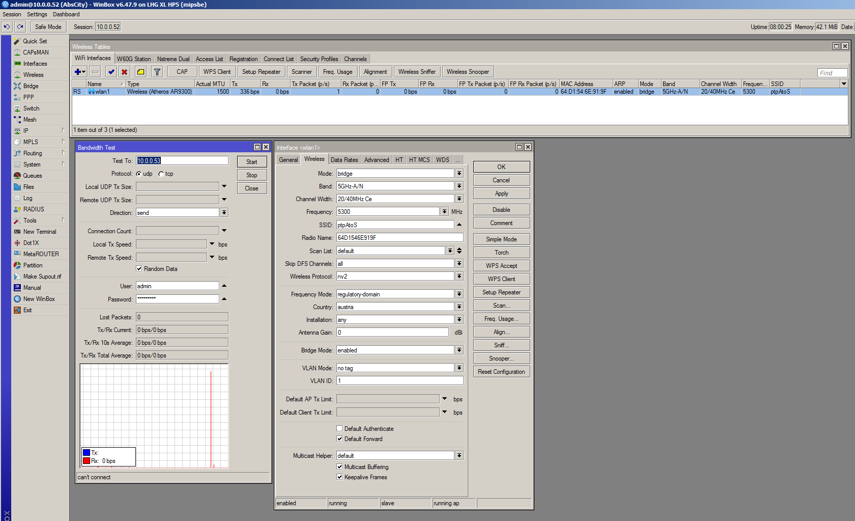

I have checked the LHG’s and the cables for damage
again fine-adjusted the LHG’s
installed the latest RouterOS Updates
tried different frequencies
reconfigured the 2 sites

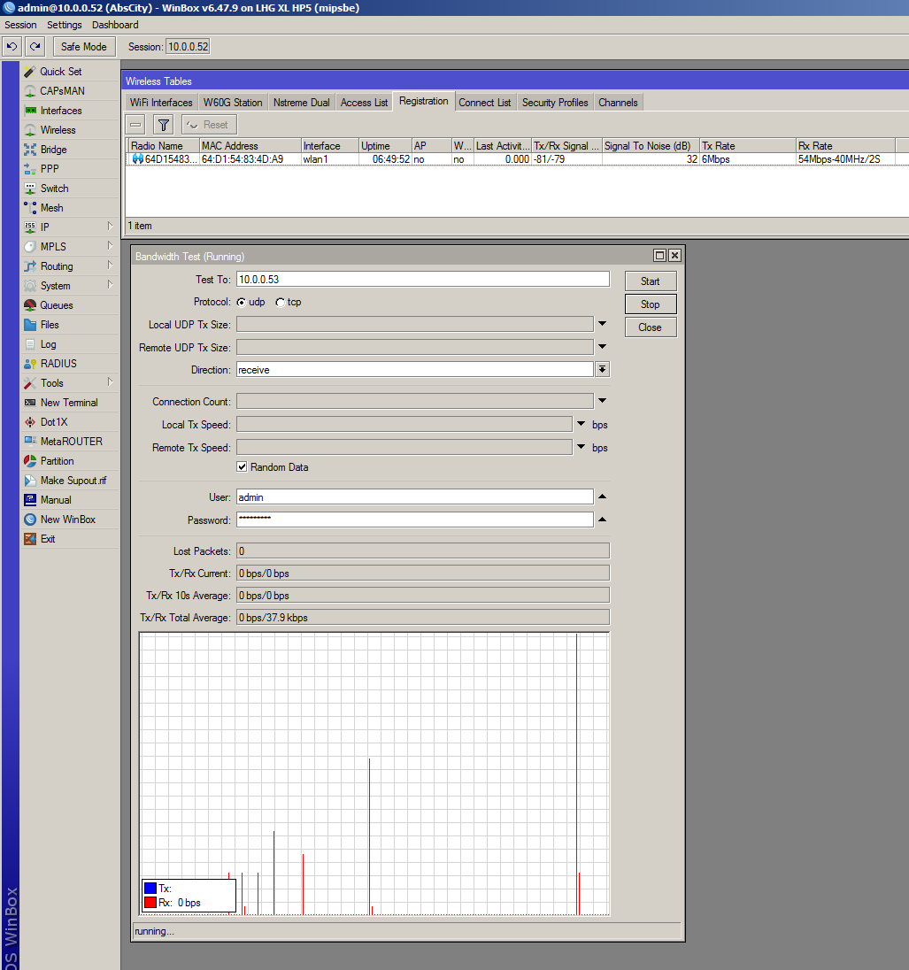

The RX-TX Signal is at about -79, S/N at about 32dB.
RX and TX Rate are at about 54Mbps.
Does anyone has an idea why there is narly no traffic possible?
