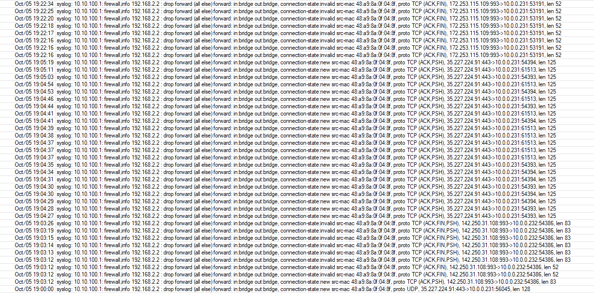

It seems to work very well but I am discovering surprising log entries coming from the RB5009’s rule:
/ip firewall filter add action=drop chain=forward log=yes log-prefix="drop forward (all else)"
such as:
drop forward (all else) forward: in:bridge out:bridge, connection-state:new src-mac 48:a9:8a:0f:04:8f, proto TCP (ACK,PSH), 17.57.144.54:5223->10.0.0.236:54877, len 685
I believe that this is a new incoming connection (from 17.57.144.54) to an iphone connected to this ax3’s guest wifi.
My question is: Should I attempt to allow this? Why would Apple (17.57.144.54) try to initiate a connection to my iphone?
If I should create a rule that allows these types of connections, what should it be?

Do not allow. If everything seems to be working do not touch that rule. It could be a leftover of any unexpectedly closed connections etc.
It is not suprising that your router is scanned by Apple. I have an issue that my router cut me off the Google services as there were scans initiated from 8.8.8.8 and my prevention rules did what they were supposed to do and put 8.8.8.8 on a blacklist.
Why and what that scans were initiated from 8.8.8.8 for … only Google and IT-God knows.

To be precise, it actually is a problem, but for sure adding a permissive rule would not be a solution to it.
As in IPv4, the majority of user endpoints have private addresses, there are not many useful scenarios where endpoints in the internet would initiate connections to them, as they could only reach the minority of user endpoints that are on public addresses. The exceptions are user endpoints that control the routers that connect them to the internet using UPnP or similar mechanisms, and those that use STUN and similar techniques to predict the NAT behavior rather than controlling it. But even these exceptions are typically used when two user endpoints, both behind a NAT, want to set up a direct communication with each other, in order to reduce the transport delay and conserve resources on dedicated traffic forwarders that have to be used if the direct connection cannot be established.
So the most typical case where you get an unsolicited packet whose source address belongs to some big company is when the packet actually came from a different source whose aim is to overload the device that listens at the source address of that packet - the attacker sends a small packet to many devices that he knows or expects to respond it, and chooses packets that cause a huge response. So using a relatively small bandwidth from himself to multiple (thousands of) destinations he can generate a much larger influx of “unsolicited responses” to the target/victim.
Another type of scenarios lacks the evil intention and can be explained by firewall behavior alone. E.g., the firewal labels a late UDP DNS response packet as a connection-state=new because the tracked connection initiated by the query packet has timed out before the response came. Another example is that the firewall drops a tracked TCP connection as soon as it has received and forwarded a RST packet from one endpoint towards the other, so it marks whatever packet comes from the other endpoint afterwards (because its sender has sent it already before receiving the RST) with connection-state=invalid or connection-state=new depending on the loose-tcp-tracking setting in ip firewall connection tracking. The default setting is yes, which means that the firewall does not check the internal state of the TCP that is expresses using the TCP flags.
So the packet from your example, which is a mid-session TCP packet, would seemingly match best to the last example (mid-session TCP packet received after a RST for that session has already passed through the firewall), as it has no potential of inducing a huge response nor it can break an existing session from any other address than your public one, if it wasn’t for the facts that it came in and left via the same interface and that it has been dstnated. A post-RST packet from the Apple address would not make it to a private address because once the tracked connection gets removed, the “un-src-nat” of packets belonging to that connection not possible any more. So it suggests that use-ip-firewall under interface bridge settings is set to yes in your configuration, causing even pakets forwarded between ports of the same bridge to be handled by the IP firewall. Is that indeed the case? If yes, what was the reason to set it like that?

It sure seems like it is your #2 explanation: timed out connection resulting in connection-state=new

Unfortunately, your conclusion suggests that the explanation wasn’t as fantastic as I would like it to be :slight_smile:
Let me reiterate - since the source address of that packet is a public one and the destination one is private, a dstnat operation changing the destination address from the public one of your home to the private one in the guest network must have taken place. So the router/firewall that has performed that dst-nat operation must either have a dst-nat rule installed (but the source and destination ports of the packet do not support this assumption) or the dstnat operation was actually an “un-src-nat” one, which implies that the tracked connection still existed on that router. So it would require a very tight timing that the router where you have seen this public->private packet would have just forwarded a RST one (and removed the connection) whilst the next router in your home would have sent that public->private packet before processing the received RST one. It is not impossible, it is just unlikely that it would happen so frequently.
The other remarkable thing about the packet is that it has been set for being sent out via the same IP interface (the one named bridge) through which it got in. This is very rare for routed packets if the network topology is properly designed and the routing properly configured. So given that use-ip-firewall is set to no, you either have multiple subnets attached to the bridge or there is an even more unusual reason why it happened. One possibility is that the upstream router has the one where you’ve caught the packet configured as a gateway to 10.0.0.0/24 but the router where you’ve caught it has yet another router in the same subnet configured as a gateway to 10.0.0.0/24. So if it receives a packet for 10.0.0.0/24, it delivers it but notifies the sender that there is a better gateway in the same subnet. Such a notification makes the sending device update its routing tables temporarily, so for some time after, it uses the “better gateway”, but once the lifetime of the notification expires, it starts using the configured gateway again and the cycle repeats.
So most likely what needs a review are not firewall rules but routing and network topology.

Here is a screenshot of last night’s log, in case it is useful.
There is only 1 device using this Guestwifi now – my own iPhone, which works very well with this configuration.

Makes perfect sense.
The IP assigned by the ISP is dynamic (Verizon FIOS home).
I don’t think I’m doing anything that rises to the level of funky. Basically, before adding the “guest wifi” to the ax3, there was internet routing through FIOS, wireguard routing, and internal routing. Adding the “guest wifi” on a separate private network (10.0.0.0/24) added a level of complexity, but I thought I configured it properly.
But, I’ve been wrong before…
Is the fact that there are 2 routes with 0.0.0.0/0 destinations a problem?
   DAd  dst-address=0.0.0.0/0 routing-table=main pref-src= gateway=100.38.160.1 immediate-gw=100.38.160.1%ether1 distance=1 scope=30 target-scope=10 vrf-interface=ether1 suppress-hw-offload=no
   IsH dst-address=0.0.0.0/0 routing-table=main pref-src= gateway=192.168.2.2 immediate-gw= distance=1 scope=30 target-scope=10 suppress-hw-offload=no
   DAc  dst-address=100.38.160.0/24 routing-table=main gateway=ether1 immediate-gw=ether1 distance=0 scope=10 suppress-hw-offload=no local-address=100.38.160.98%ether1
The ax3’s routes are:
[admin@212hAP-Ax3] /ip/route> print terse
0  As  dst-address=0.0.0.0/0 routing-table=main pref-src= gateway=192.168.2.2 immediate-gw=192.168.2.2%bridge distance=1 scope=30 target-scope=10 suppress-hw-offload=no
  DAc  dst-address=10.0.0.0/24 routing-table=main gateway=Guest5g immediate-gw=Guest5g distance=0 scope=10 target-scope=5 local-address=10.0.0.1%Guest5g
  DIcH dst-address=10.0.0.0/24 routing-table=main gateway=Guest2g distance=0 scope=10 target-scope=5 local-address=10.0.0.1%Guest2g
  DAc  dst-address=192.168.2.0/24 routing-table=main gateway=bridge immediate-gw=bridge distance=0 scope=10 target-scope=5 localaddress=192.168.2.5%bridge
Two routes with the same destination may be both a desired setup or a wrong one - it depends on circumstances.
E.g. if you had two WANs, two default routes could be a desired setup, as the ultimate destination would be the same one (some host in the internet) and reachable via both routes. But neither of your cases fits into that category:
  • the default route added dynamically via DHCP is OK (and the only problem I had with it was that it was missing in your initial “simplified” configuration export), the manually added default route is wrong in terms that its gateway address is an own one of the router. Luckily, although the router did not prevent entering that route into configuration, it marks it as Invalid and does not actually use it.
  • the two routes to 10.0.0.0/24 on the hAP ax³ are a different case, as the router has no way to determine through which of the two interfaces to which 10.0.0.0/24 resolves to send a packet for 10.0.0.x that comes from the 5009 unless you use some advanced techniques (connection marking in firewall mangle based on source interface for the wireless->5009 direction and route marking based on connection mark for 5009->wireless connection). The steps are
  1. find the gateway interface towards the destination IP address using routing
  2. from that interface, send an ARP request asking for the MAC address of the host that has the destination IP address
  3. note down the MAC address from the ARP response and the interface for the destination IP address for a couple of minutes in the “ARP table”
  4. encapsulate the IP packet into an Ethernet interface with the MAC address from the ARP table
    Steps 2 and 3 are only taken if the ARP table for the IP address is empty. But the router does not “fork” the packet to multiple interfaces.
