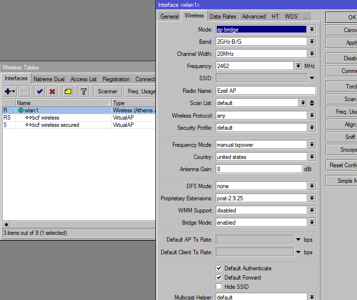

what would i need to do to make one of them work off of a wds link and broadcast the same SSID’s as the original.
ok will this work.
i will refer to the AP with a wired connection as MAIN and the AP that i can not get a wired connection to as REMOTE
the only thing that throws me off is that im not just broadcasting 1 SSID.
i have 2 virtual AP’s created bridged together with VLAN’s to do tagging.
could i setup both tiks as AP’s as listed in the above config (this is the config that i use all over the campus and works fine) and then create a WDS interface on both, and create a bridge with the ETH and WDS interface in them (with the MAC address of the opposing WLAN interfaces configured in the WDS settings)
what am i missing.
is this the right way to do it?
is there an easier way?
i have attached a few pix of the current config to see if that would help
1 more
