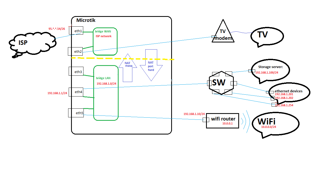

I am trying to implement a simple home solution using Mikrotik RB450 device.
Below is my configuration, but NAT does not work (as I expected).
Please, advice:
Shall I assignee the IP address to WAN and LAN interfaces instead of ether1 and ether4 ? hence, the NAT option “in-interface” as well to WAN and LAN
[]95...1 > WAN
]192.168.0.1 > LAN
or otherwise:
Shall I adjust the IP route to interfaces ether1 and ether4 instead of WAN and LAN ?
[] 0.0.0.0/0 > ether1
]95...0/26 > ether 1
[*]192.168.1.0/24 > ether 4
Additionally, ping does not work as I expected. The ping is possible only when using the WAN or LAN interfaces (ether1/4 does not work).
