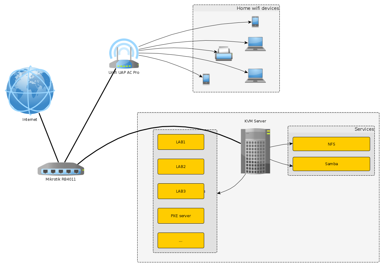

I’ve recently bought a RB4011iGS+ for my home network. I’m using it for my home devices like phones, laptops etc. as well as for my KVM server with 10-20 Linux virtual machines that i create, use and then remove after i’m finished with my excersises, software testing etc. There are servers running on them and may need to be made available on the outside of my network, so i will be forwarding some ports from time to time.
I have not yet divided my network into VLANs.
The attached diagram shows my home network.
I wish to establish a solid, base firewall to use the router’s potential, not overload it by useless or too many rules and still make it work the way i’d like to.
