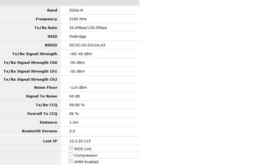

Hello i have to SXT in bridge mode. they seems to be correctly aligned but i have some packet lost
i don’t know if the signal is too high or too low. the speed never stop to vary !
here i paste a screen shot of one antenna. i don’t know if the POE injector is too far but i don’t think its the problem because the antenna don’t freeze or stop to work just sometimes a ping is lost. many thanks
-47 signal is too strong. try to move the antenna away until you get -55 or -60
