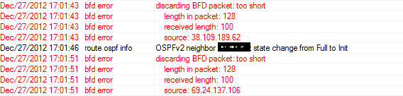

About a week ago, I lost connectivity at my core. My core router became virtually inaccessible. I could only log on remotely for a couple of seconds before I would get kicked. Once I got onsite, it was still the same way. I could log in for just a couple of seconds before I would get booted.
I could not create a support file. The only tidbits of info I retrieved is that the cpu was at 100% and I took a screenshot of the log.

I attached the screenshot of my log and the only thing it shows is a BFD error? Does that tell a person anything?
Is there a way to tell if the traffic was from an attack? Could a faulty network component cause the issue I was having. My isp said they did see my traffic spike through their network when the issue happened so it wasn’t some false reading that I was getting.
It sounds like you got DDoS’ed hard.
The BFD problems were due to the CPU going 100% constantly and not being able to keep up with BFD updates, and the OSPF peer went down as well because of the BFD fails. But the BFD failed only because of the DDoS.
