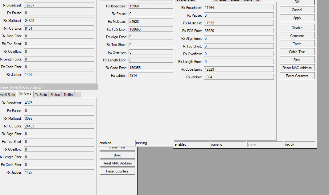

Dears
I Faced problem FCS error on many Routerboard and links
It’s not fair , because is see ether running but FCS counter increase, until disable ethernet and enable to solve this issue
I change :
1-Cable
2-power Injector
3-RB
I turn off auto-negotiation not solved
I mark just 100M not solved
i turn on rx-flow-control not solved
it’s repeat more than 30 times in day
Please can any one help me
FCS errors are caused by bad cables, bad cable installation, or a failing port. Check the cable and the device at the other end.
