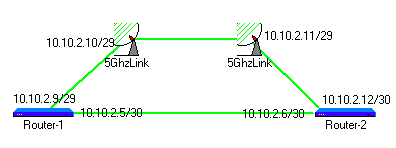

Hi all,
I have some questions and need some help… I need use two link for share traffic or make failover link. I try to draw simple diagram to show and explain.
and here is setting ;

How can i share internet on both link to use both of them ? and is possible to use 5ghz link for backup ? if one link down other link should continue.
and further more did i made correct settings for ospf ?

I changed the cost to 10 both of them and now traffic goes both interface.. is this correct implementation ? should i change the gateway on router-2 or any extra setting ? and can you check the settings of ospf if correct :slight_smile:
Yes, that’s ECMP in action.
No need to do anything for failover, test that for yourself by disabling any of radio link interfaces. Traffic should flow through the other. Routing takes care of that.
