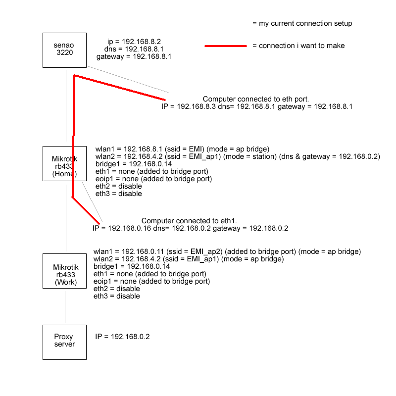

I have setup eoip and bridge. Becos the rb433(at home) is connecting to another rb433(main). So now i have added another wlan cardto my rb at home. And the ip range is 192.168.8.0/24.
I want to be able to share files woth a user on the 192.168.8.x range. My ip is 192.168.0.16. I cannot setup another eoip becos the client that connects to my AP is not using mikrotik.
thanx
post a network diagram, please
Hi here is n diagram that i have made. Please note that the rb433 at work has a wlan interface with ssid = emi_ap2. There is another senao connected to that ap and it seems to be working fine. The problem is between rb433 home and senao 3220
