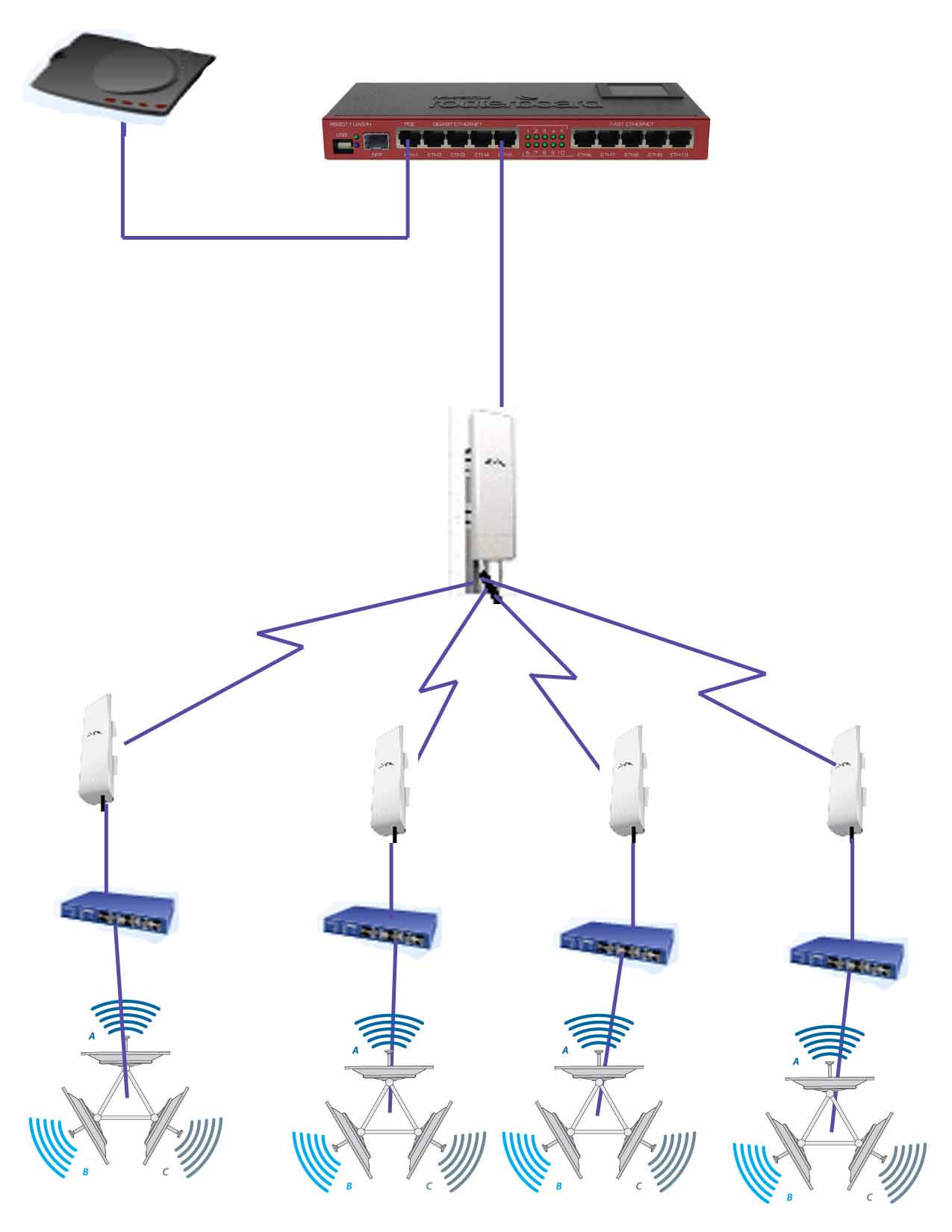

Make a draw from your network infrastruture
what does that mean??
Make a picture from your network infrastructure
Here is my diagram…
Internet in from ISP to eth1 of RB2011uas_in
ETH5 connected to Nanostation M5
Nanostation M5 backhauled to 4 towers to individual M5’s
wired to gigabit switch and wired to 3 AP’s channels 1,6,11
I think my problem is natting…but not sure what to check to see if this is the problem…
I was told that I have a triple NAT and that is making it slow…
But please review and give me your comments…
What for IP-range use u?
Is ISP connect with DHCP-client?
How match users?
How match distance between the links
I don’t use switches but routerboards for split the network in different ip-ranges.
from ISP to router is 10.1.10.?, dhcp client on router…
local bridge on router is 192.168.88.?
Hotspot is 172.16.0.?
distance from main radio to towers is less then half a kilometer
less than 100 users on average…
