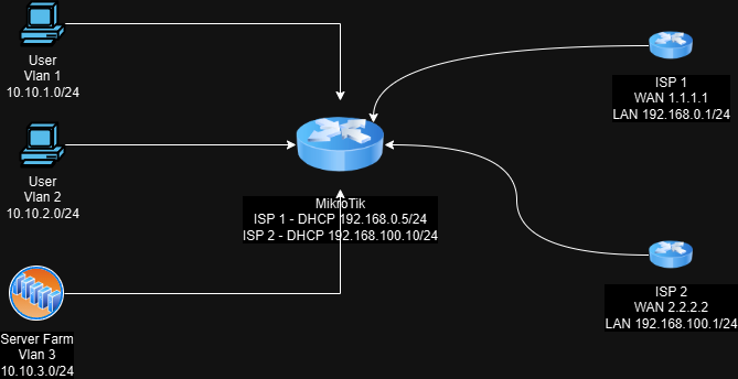

Hi, first of all I would like to apologize if this topic has been raised for multiple time by others. I have already searched and do some of the said solution, but none of them works. Hence, I am creating this based on my own situation and network environment.
First of all, this is my network diagram:
What I intend to do is, I want to port forward http port 80 to the LAN inside. But the thing is, my LAN is on the double NAT. I have no problem doing port forward from the ISP router to the Mikrotik router itself. But I got problem when I tried to port forward from the ISP router to the LAN behind the Mikrotik router.
Together, I attached the configuration I have made. Please note I also have PCC mangle load balancing running as well. I don’t want to lose that since I have 2 WAN links connected. What should I add if I want to port forward from the WAN 2 or from both?

Watch this video from MikroTik.Starting from 6:47 - Match outgoing traffic to incoming:
https://www.youtube.com/watch?v=nlb7XAv57tw&t=407s
