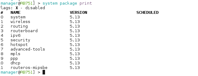

Please inform us about packages, that are installed on your routers.
Post here the output from /system package print.
751U with 5.13 packages. I have not succeeded getting the board working with 5.14 .
