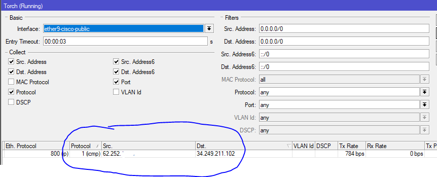

The torch tool shows a ping i am running to 2.1.1.1 (real ip 62.252.x.x in screenshot) from outside is being sent to ether9 and it appears it is responding but the ping fails, so, is it a firewall issue where traffic from ether9 cant go back out, like some nat or forward rule?
