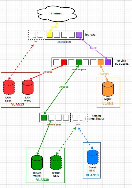

I am trying to set up a home network. I have a new hAP ax3 that I just received. I have a tp-link TL-SG108E managed switch. And I also have a Netgear Orbi RBR750 with 2 satellites that is in Access Point mode. The goal is as follows:
  1. I want to have the basic LAN which will have some wired connections to a few computers and printers, and a Synology NAS. I wan to have the hAP ax3 wifi on this LAN with the main SSID so that my smart phone can connect to the LAN for email. etc.I want the wifi to use the LAN DHCP to get IP addresses. I will have one Untagged port in the swtch for the LAN. There will aso be a Tagged trunk port that is shared by all of the networks.
  2. I want a vlan that will use the Orbi wifi access point. I will have 4 Untagged ports in the switch for this vlan. The Orbi will have a static IP as will the satellites. The DHCP will be the hAP ax3.This network will have a different SSID. It will be the access point for about 50 or so IoT devices that will be controlled by a Home Assistant also on this vlan, except it is a wired conenction.
  3. I will also have a Guest network that is on the Orbi as well. The Orbi actually has a built in DHCP for this Network, so I am assigning a static IP to this SSID, but no Untagged port on the switch.
I have evertything setup and all of the devices are conncting to the correct location and getting the correct IP from the correct DHCP. All 3 SSID’s are showing up on my smartphone, and I can connect to each of them and get the correct IP But here are my issues:
a) The Guest network connects to my smartphone but has no internet access.
b) There is a long lag before I can connect to any site on the internet, often timing out before the connection completes. I am certain this is related to my setup and not the equipment itself. If I connect directly to port 2 on the hAP ax3, I see immediate connection and nearly 800Mbps on a wired connection. I also have nearly 200Mbps wireless. When I connect to the tp-Link switch on an unmanaged port I see the same wired speed. And when I connect to the Orbi with an unmanaged port I also see those same speeds.
I am guessing it is a firewall issue? I can’t see how it could have anything to do with the ports being tagged or untagged. They do no thave any contorl over the port speeds. I would appreciate any help or suggestions. I cna post config file if needed.

Draw a network diagram to make it clearer…

I made an image and it is attached. Please offer suggestions on what I think I want to get to.
Mike

Easy Peasy.
You need at least 4 vlans
a. management vlan99
b. homevlan vlan10
c. guestvlan vlan20
d. iotvlan vlan30
Router–> Trunk port to TPLINK switch → static lanip on 192.168.99.0/subnet ( vlans 99, 10,20,30 )
TPLINK – > Trunk port to Orbi device → static lanip on 192.168.99.0/subnet (vlans 99,20,30 )
e. I would take one port on the hapax3 #4 for example and make it an off bridge port to do the configuration.

Thanks so very much!!! I have it set up as shown in the image right now, and none of the Red wired devices have access to the internet (the wireless devices do have access) and I have no idea why. I assume it is a firewall rule?
