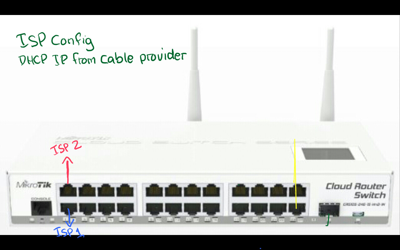

My problem is i'm not getting IP address on WAN2 from my modem.
WAN - Is this possible to have 2 Dynamic IP connect to the router ?
WAN 1 - Port 1 - Dynamic IP from the ISP
WAN 2 - Port 2 - Dynamic IP from the ISP

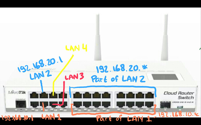

LAN
LAN 1 - Port 3 - 192.168.10.1 (DHCP Pool from 192.168.10.100-192.168.10.254)
LAN 2 - Port 4 - 192.168.20.1 (DHCP Pool from 192.168.20.100-192.168.20.254)
LAN 3 - Port 5 - 192.168.30.1 (DHCP Pool from 192.168.30.100-192.168.30.254)
LAN 4 - Port 6 - 192.168.40.1 (DHCP Pool from 192.168.40.100-192.168.40.254)
For the LAN,
I would like to have port 9, 11, 13, 15, 17, 19, 21, 23 - as part of LAN 1 (port #3) with subnet 192.168.30.*
and
port 10, 12, 14, 16, 18, 20, 22, 24 - as part of LAN 2 (port #2) with subnet 192.168.40.*
I'm attaching some pics with drawings, hopefully it makes sense.
Anyone ? help ?
Thanks :slight_smile:
You need to delete the default bridge, change ports to master ports that you could route, nominate one master port for each lan and bridge the rest slave ports to that master port (new master ports, new slave ports). Set IP addresses on each of the master ports. you’ll end up with a total of 6 routed ports (4 master LAN + 2 WAN)
