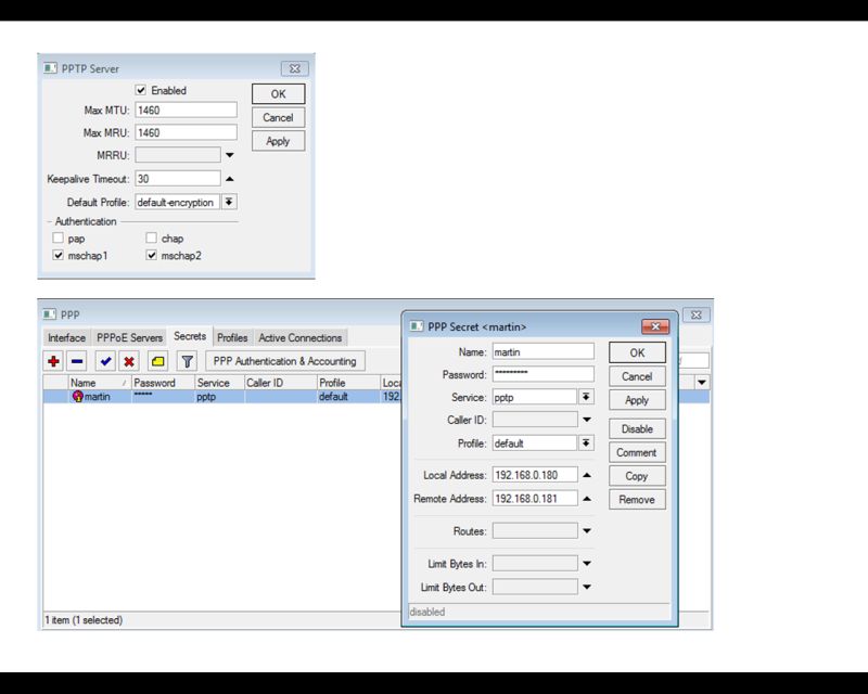

I am trying to set up a VPN to my network at home, but as so many times before my knowledge goes in in short, so I am again counting on some help from this great board.
I tried to follow Gregs’s guide http://gregsowell.com/?p=680 and also tried a couple of other guides, but with the same result.
I have tried from both windows 7 and windows XP, but all attempts seems to be stopped in my firewall. Could you tip me in the right direction what to look out for - or what I should open in the firewall / services.
