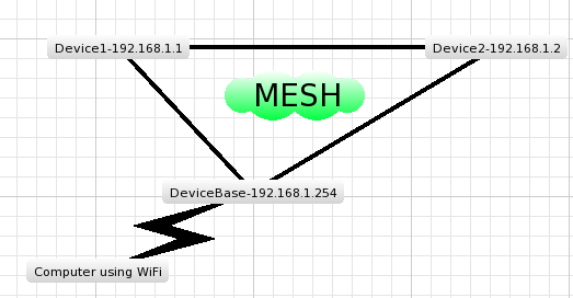

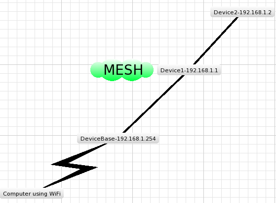

3 units using NV2 that connected in MESH
the units are not static.
so sometime unit 1 can see unit 2 and 3
sometime unit 1 can only see unit 2
I need to work at tdma (NV2) with this 3 units
