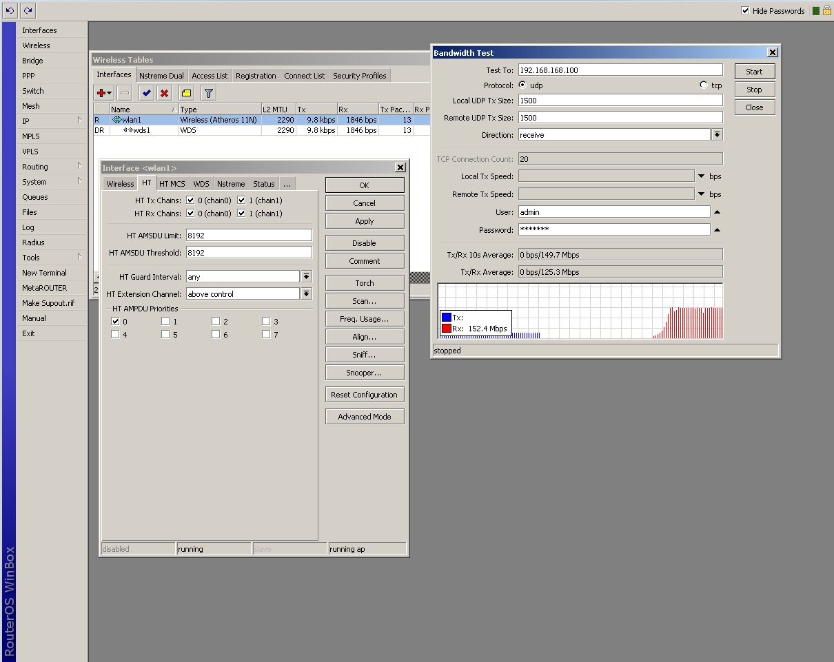

I’m an employee of one of the distributors in germany. We got big problems with setting up a point-to-point configuration with the 802.11N-settings and the RouterOS 4.3. We tried every type of configuration but it didn’t work as desired.

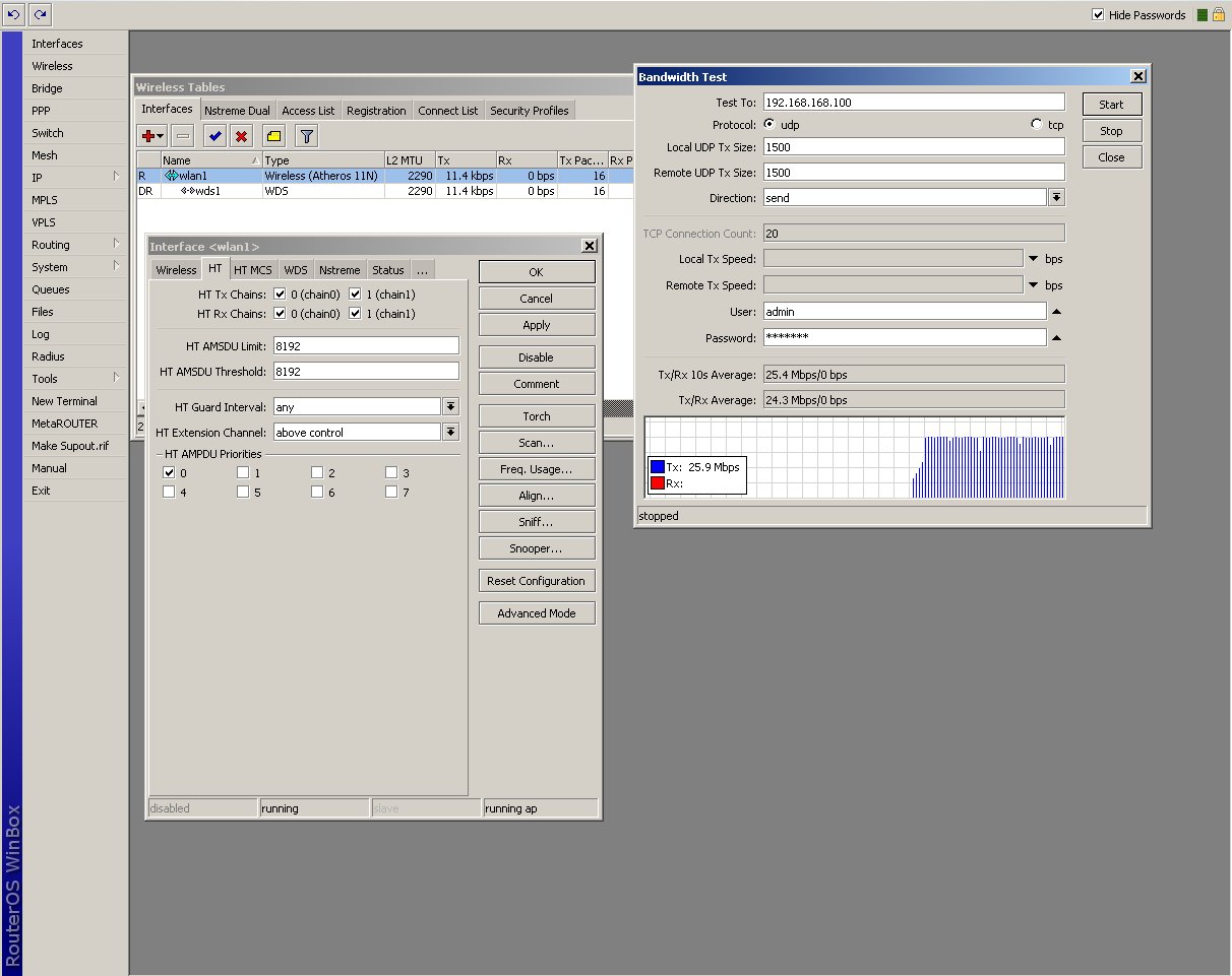

Our HT-settings on the AP:
Our HT-settings on the Client are exactly the same. Or do we have to change some settings?
We’d read the setup_guide in the wiki for RouterOS v4.03beta, but we think it must be possible to set-up the link with v4.3, too.
Do you know, whats the failure in our settings?
